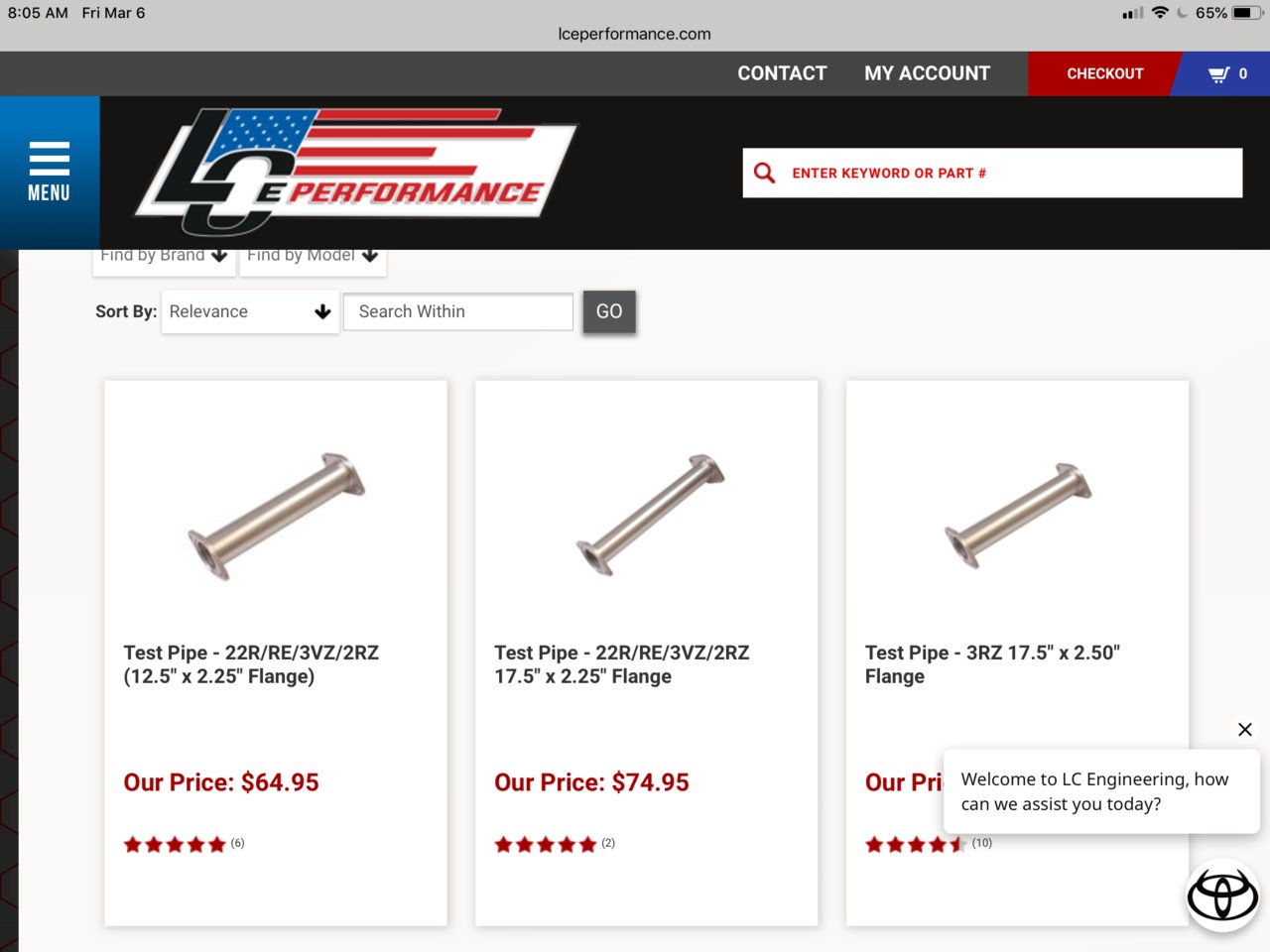

    If your burning through your cats or they are getting plugged up with a code you have another problem going on.
    A simulator will eliminate the cell light but the cats will continue to plugup
    and slowly get worse performance over time.
    You can get a replacement tube section to replace the cat if your going to use the
    02 simulator for 100.00 and not worry about it plugging up if your not an emissions state
