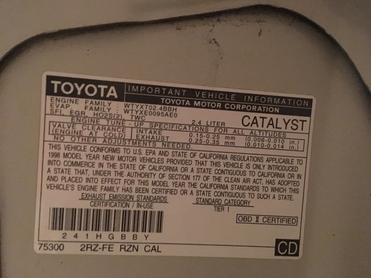

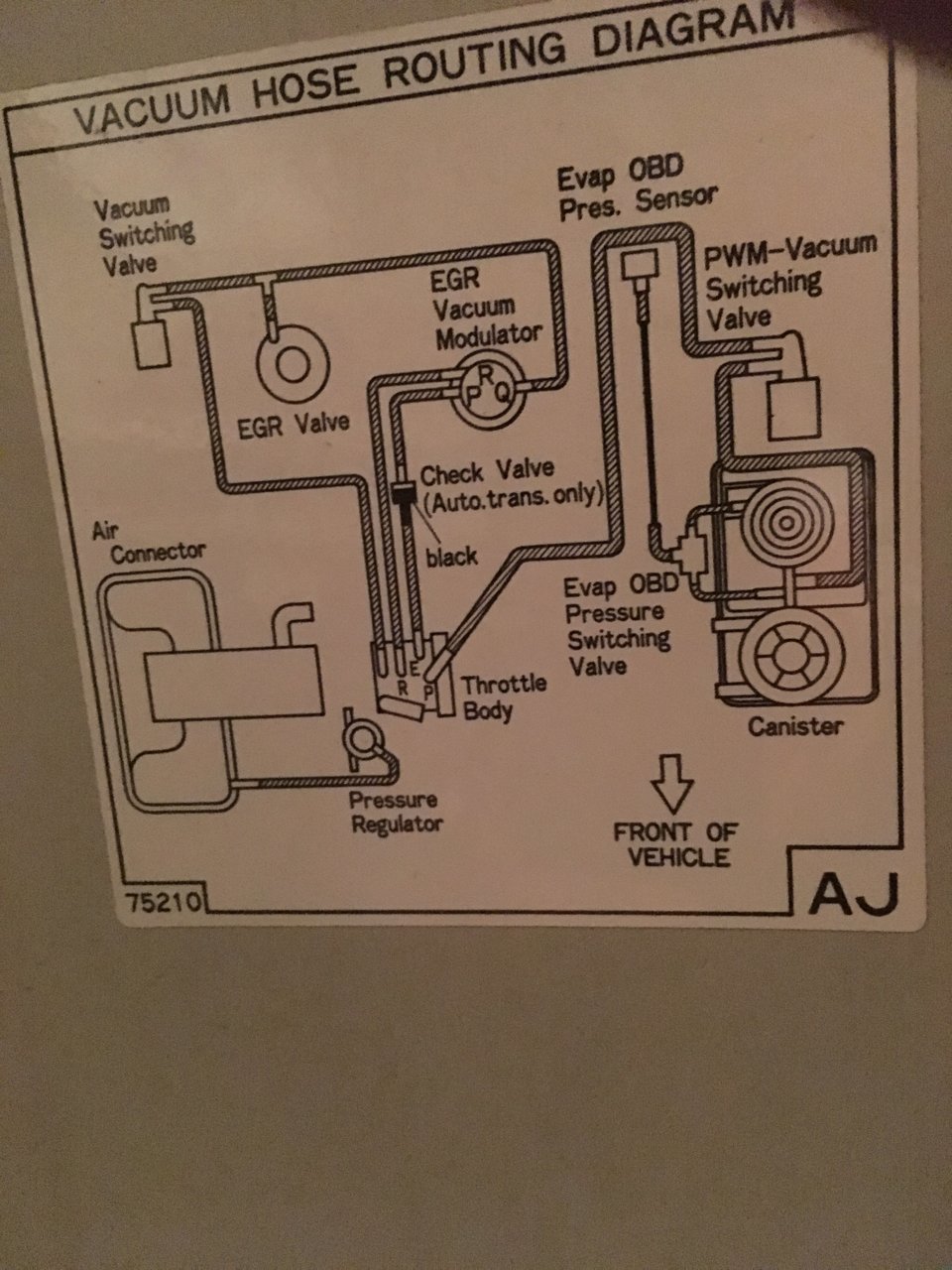

    Can you take a picture of the sticker under you hood that lists what it is equipped with? That way j can show you the right sensors to get for it.

    Here ya go, Thx.

    Speedytech7, any chance on identifying the correct sensors before I order them?

    I got you... Gimme a min

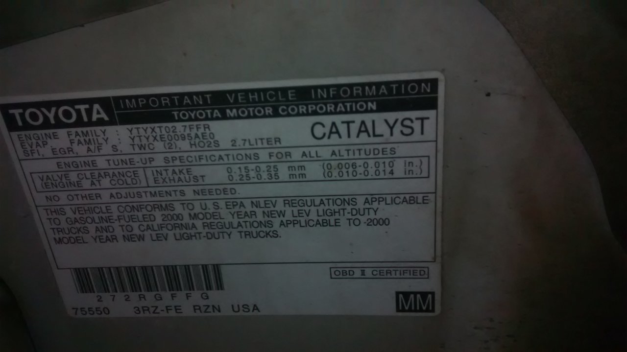

    Now I know why the front sensor connector wasn't matching..... it's supposed to be an A/F sensor and not a o2 sensor like I thought... so the part I needed was in fact 234-9001. Now I have a nice p1130........ glad I kept the still good old one, just in case...
    strange that it does not list it anywhere as compatible with my truck as it turns out this is the part I needed as well... well, at least my hack worked, p0141 is not back

    That's why I asked to check that label know his hood, it will say AFS if it needs to be an AF sensor.

    seems my truck is both federal and california?
    I was like, "to hell with california emissions! I'm in canada"... but apparently I can't do that, as I just found out...
    So, other than this A/F sensor, is there other things I can't replace with non-cali? what about the cats?
