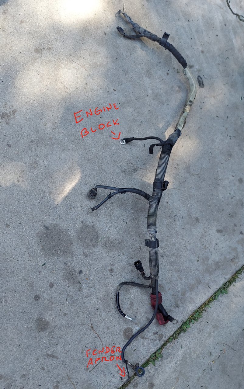

    The battery cable harness has the ground straps built in. In addition to the one already posted at rear engine/firewall.
    I just did a big 3 upgrade for a TW member and it's a bitch taking apart the loom and running new wire. I would add wire outside the loom to the body and engine block to keep it simple. Here is the original wiring below. I marked the ground points.

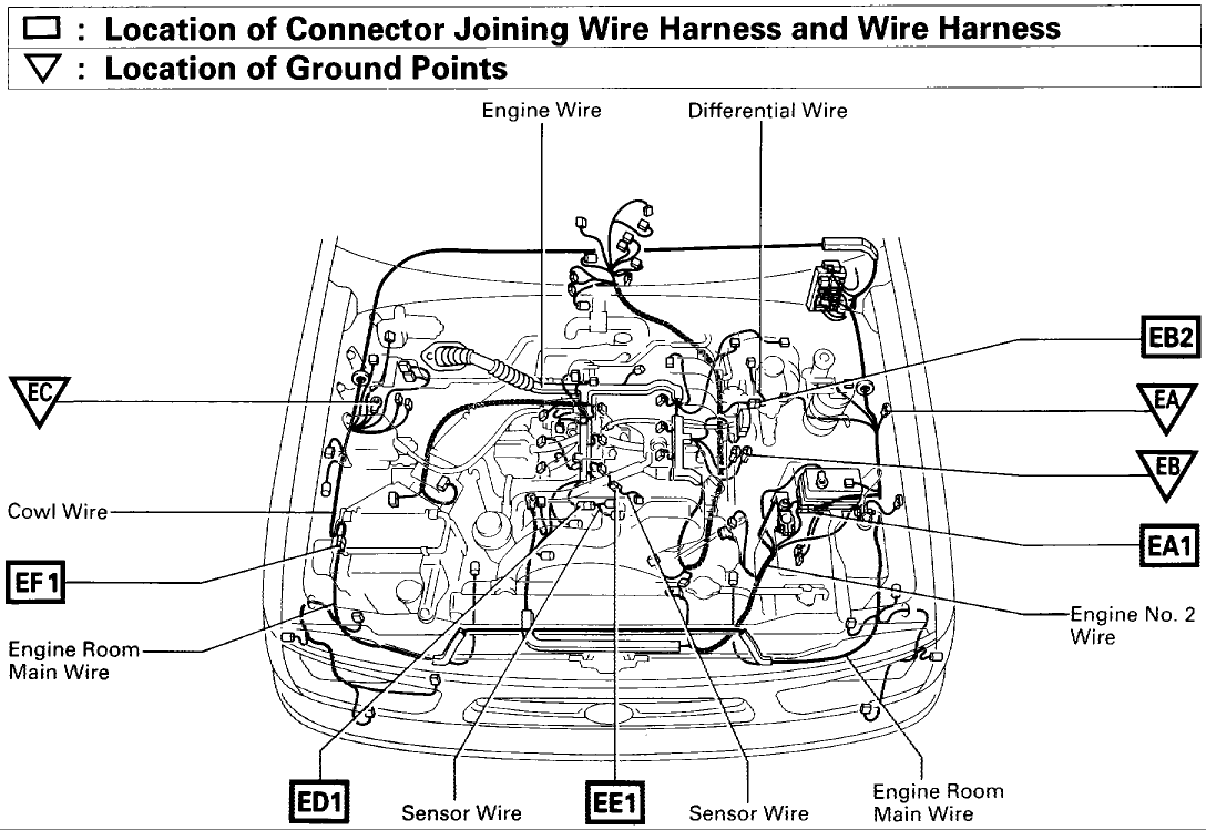

  19. Mar 11, 2022 at 12:15 PM
    #19
    O'Silver_Taco
    O'Silver_Taco Well-Known Member
    Aug 26, 2021
    #375390
    3,995
    MD
    98 Dlx Sr5 ext AT Rwd
    3rz to 2Rz bebuilt block and new heads
    The triangles note the harness ground points.....
