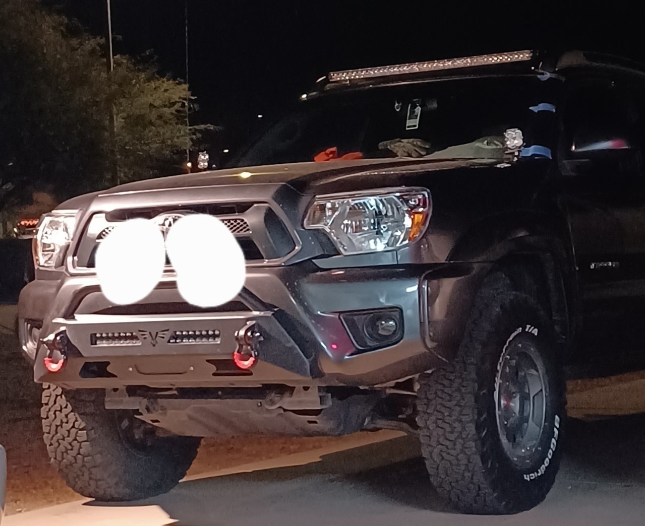

    I bought a winch recently, and the guy threw in a pair of Ironman 4x4 7" driving lights. I am considering welding two tabs onto the bull bar of my bumper and mounting them there. I am just wondering if they would have too much of a draw with my 41" roof light bar, my Baja Designs squadron sports on my ditch lights and my 20" Rough Country light bar in the bumper.
    Additionally, I am concerned it would look too tacky having so many lights. I am considering removing the Rough Country light bar and just putting a plate there, since that light bar is rendered mute by the roof light bar. Any help would be appreciated! Thanks in advance.
    Here's a picture of what I'm thinking as far as light placement goes:

    Tacospike
    Nov 19, 2018
    #273198
    14,420
    512
    Two Trucks
    Are they all white in color?
    PilotBoy352[OP] likes this.

    If you need the lights you need them. If you are concerned with tackiness/too many lights, would I get rid of the freebees and buy lights that will fit more discreetly in your current setup. i.e. buy the lights that fit your bumper. I personally think amber lights are useless and the hood mounted ditch lights look tacky, but that is me. Each to their own.
    As far as electrical draw, you will be fine. Back in the 80s, your lights would dim when idling, a then go full bright when you step on the gas and that would even happen with a 2 battery/isolator stetu. LEDs barely draw anything.
    I have my long range/throw on the roll bar. Intense spots on the push bar, and then just a light bar underneath for a euro/wide pattern
    Headlights only
    Everything on

    Too much is definitely too much IMO, but again thats personal taste.
    If you're after the practical illumination aspect, ask yourself how much light do you really need? I rock 2 cheap Amazon knock-off spots on my ARB bar and two nice ditch lights. That combo is more than enough light for just about any condition in the woods. And if theres any other traffic around anywhere you have to shut them all off. You will blind others with just one of these lights, so dont be that guy
    One last thing is the wiring needed. Obviously fusing as close to the battery as possible is the best way to protect against catastrophic failure. But 2x lights = 2x as many wires, switches, relays, you get the point. If you do go for the new lights maybe look into some sort of power distribution block like a Bussmann or similar to clean up all the wiring
