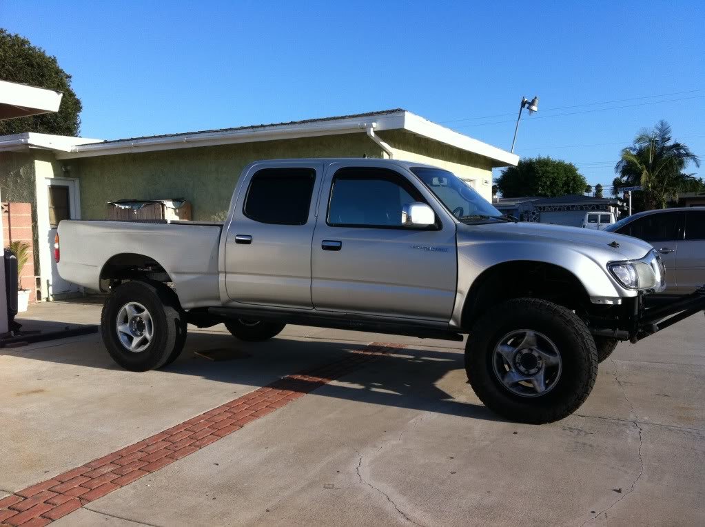

    those 35's on the 1st gen look cupped up bad in the front. he needs to rotate them more often

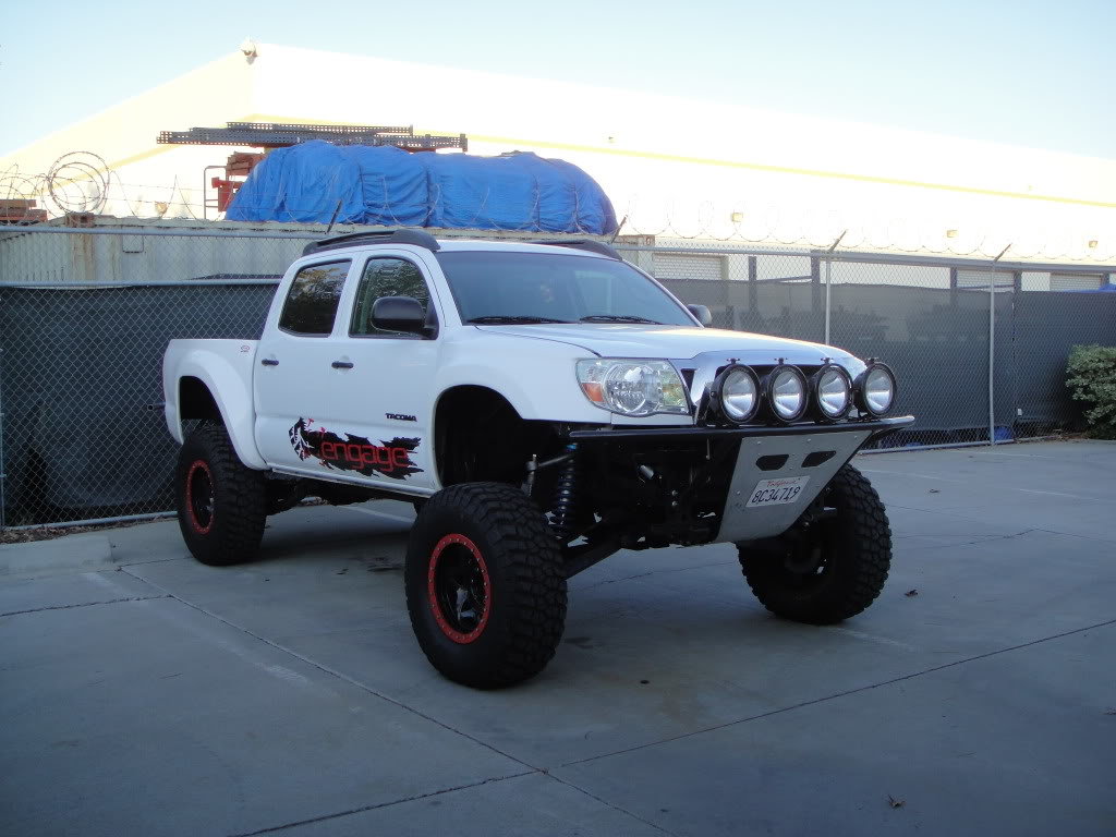

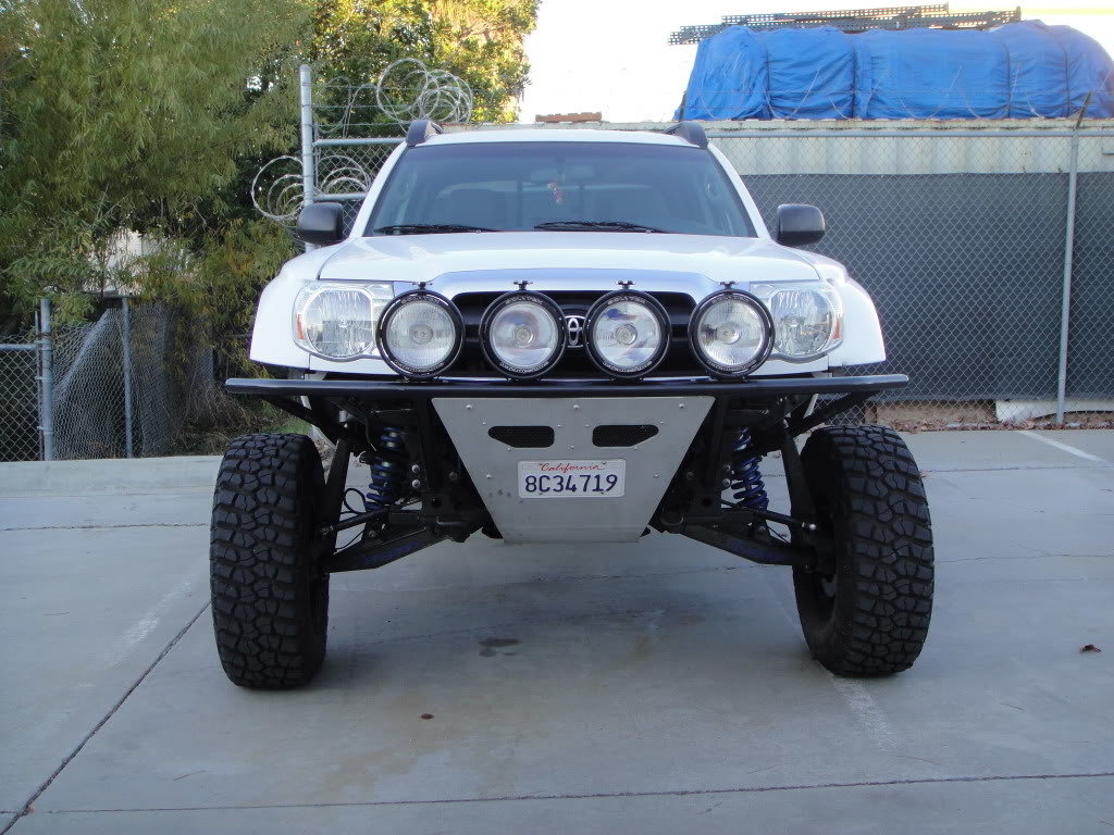

    truck looks sweet man!! how much down travel do have right now??doesnt look like you have too much preload on the co's just looking at the uca angle?or is that just how the engage kit sits? i does make those 35s look small crazy

    went from a 600 to a 550 to drop the front down a bit

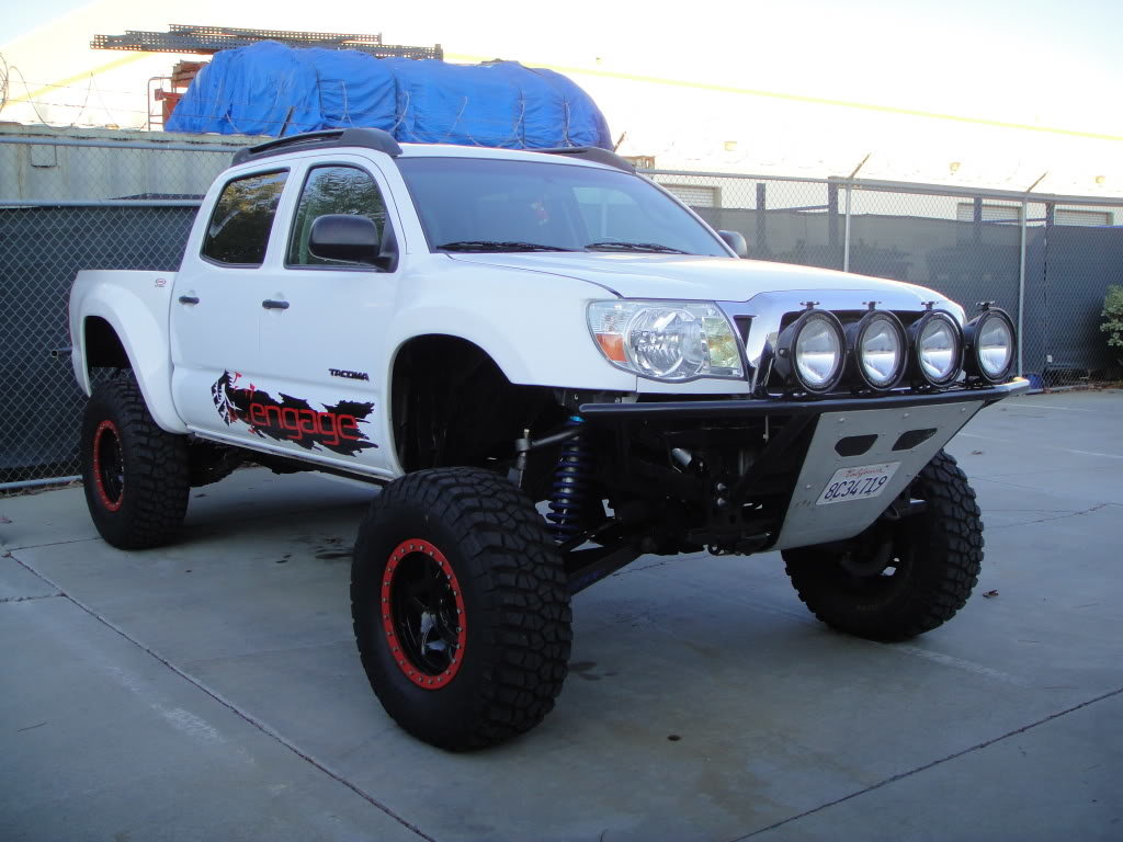

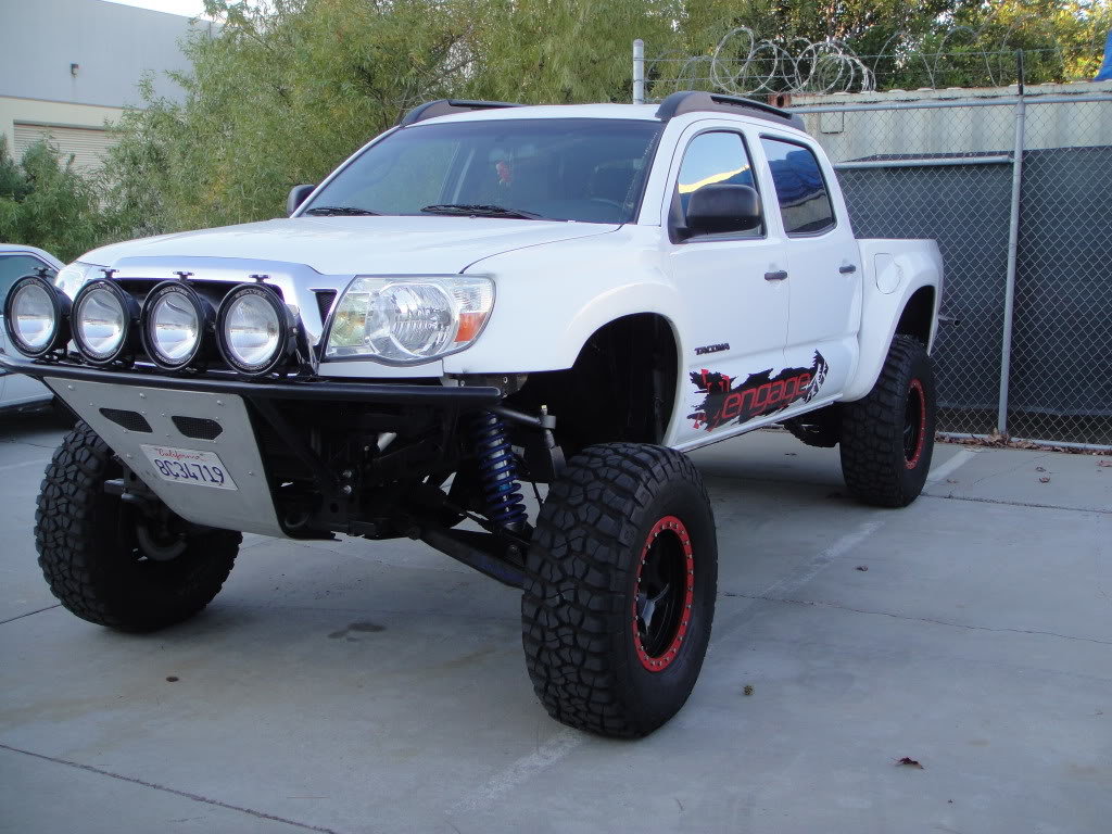

    Who made your bumper? And do you have a rear bed cage ?

    Engage made the front bumper, bed cage is not done yet, still work to do for two spare tires

    Where's the DSM Stickers?? :spy:
    Truck looks sick, vato!

    can you tell a difference yet in ride height from the spring swap?

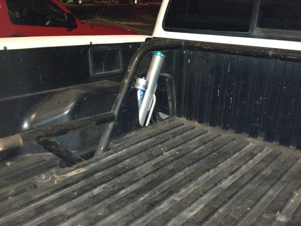

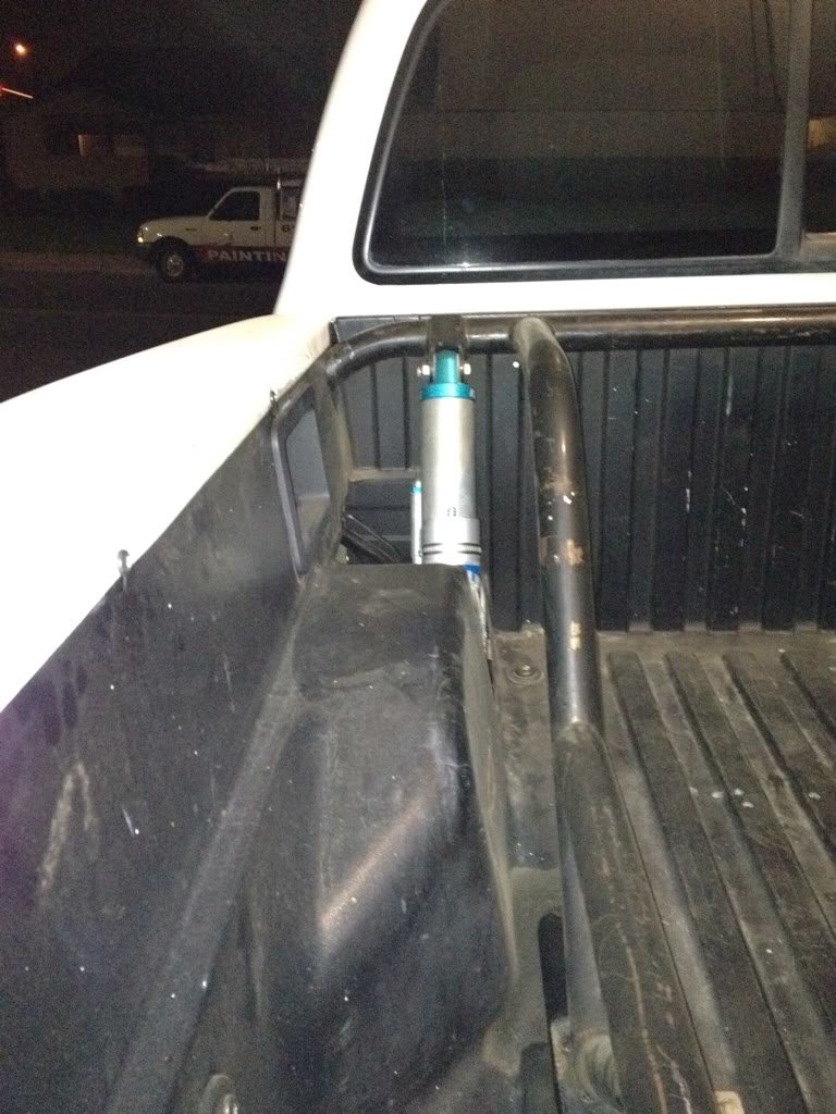

    So your running just a spring under 50t with shocks mounted in stock location?

    he has the cage, just needs to add tubes for the tire carrier...

    I'm running 50T spring under with shackles, 16" triple bypass bolted on a bed cage( shock mounts are ready but spare tires part is not ready yet)

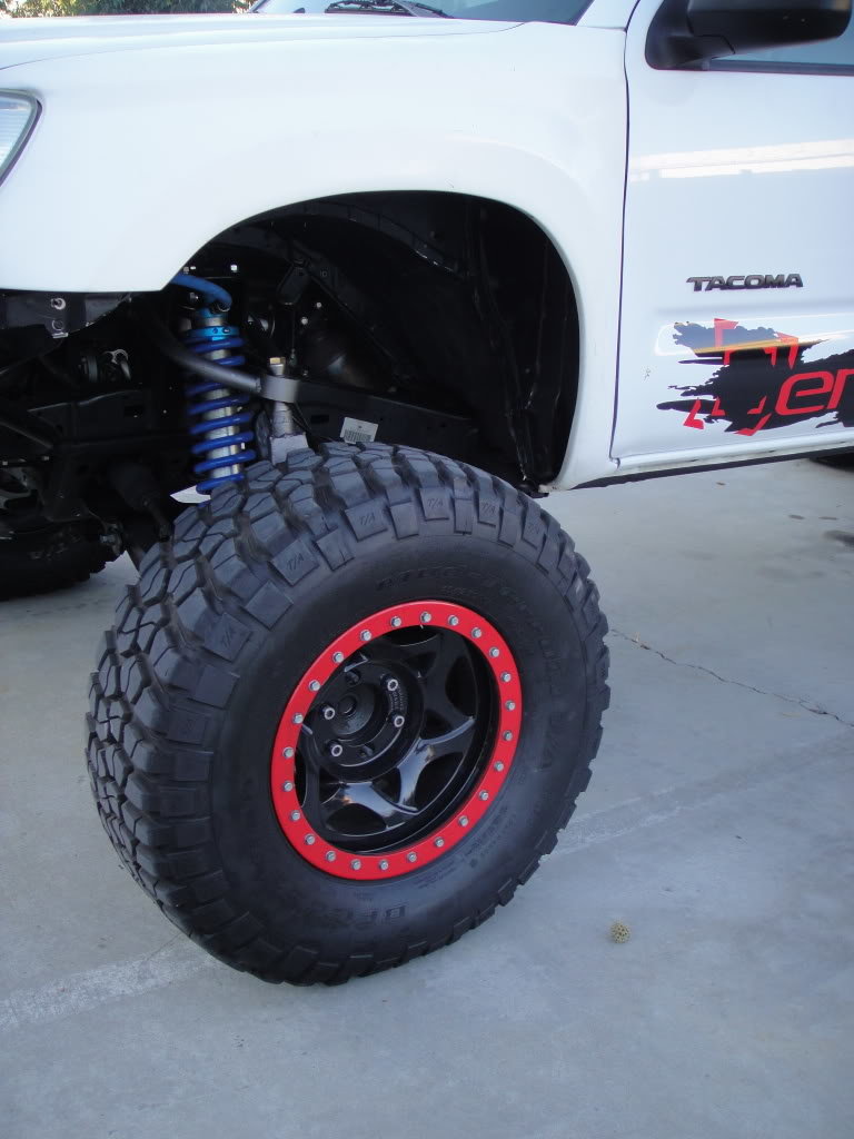

    schweet wheels!

    Tnx :D I also have two same wheels for spare ones

    I spy the same engage bed cage I have :p

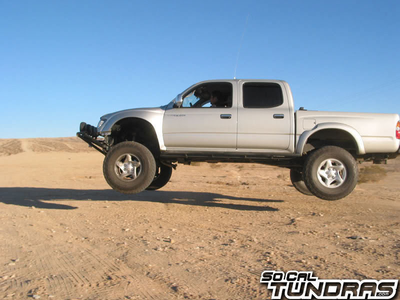

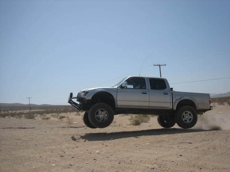

    You forgot these old ass Barstow photos from back in the day JOhnny LOL

    yeah i still have those on my computer hahaha good old memories

    Good old days

    it sits slightly higher in the front compared to my stock spindle but the new springs still need to break in, i like the stance though, remember one thing if you have lift spindles and try to lower the right height to much you will get negative camber /--\
