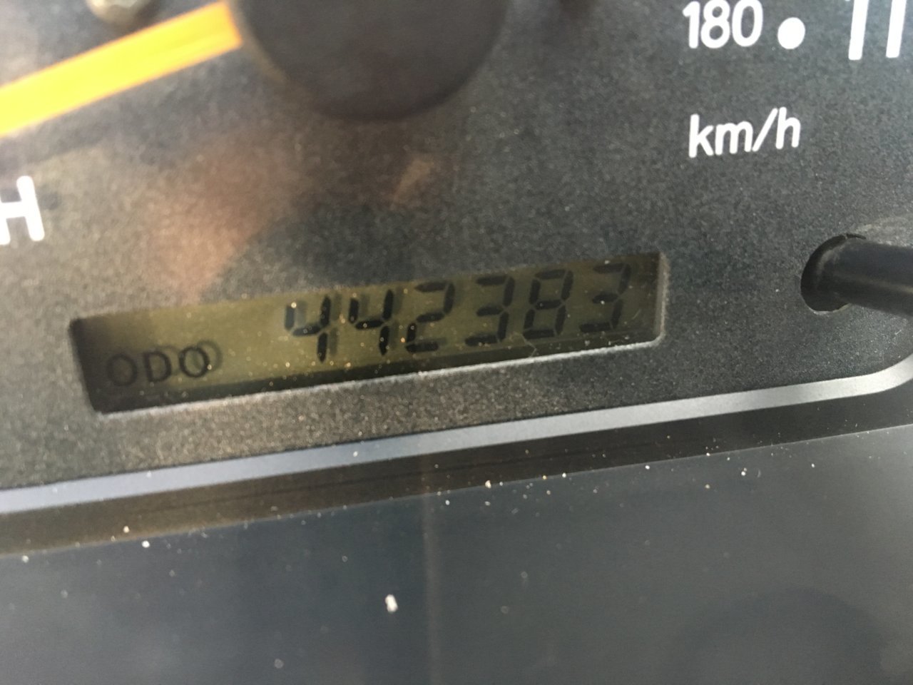

    Flux Capacitor
    442,383
    See build thread in my signature.

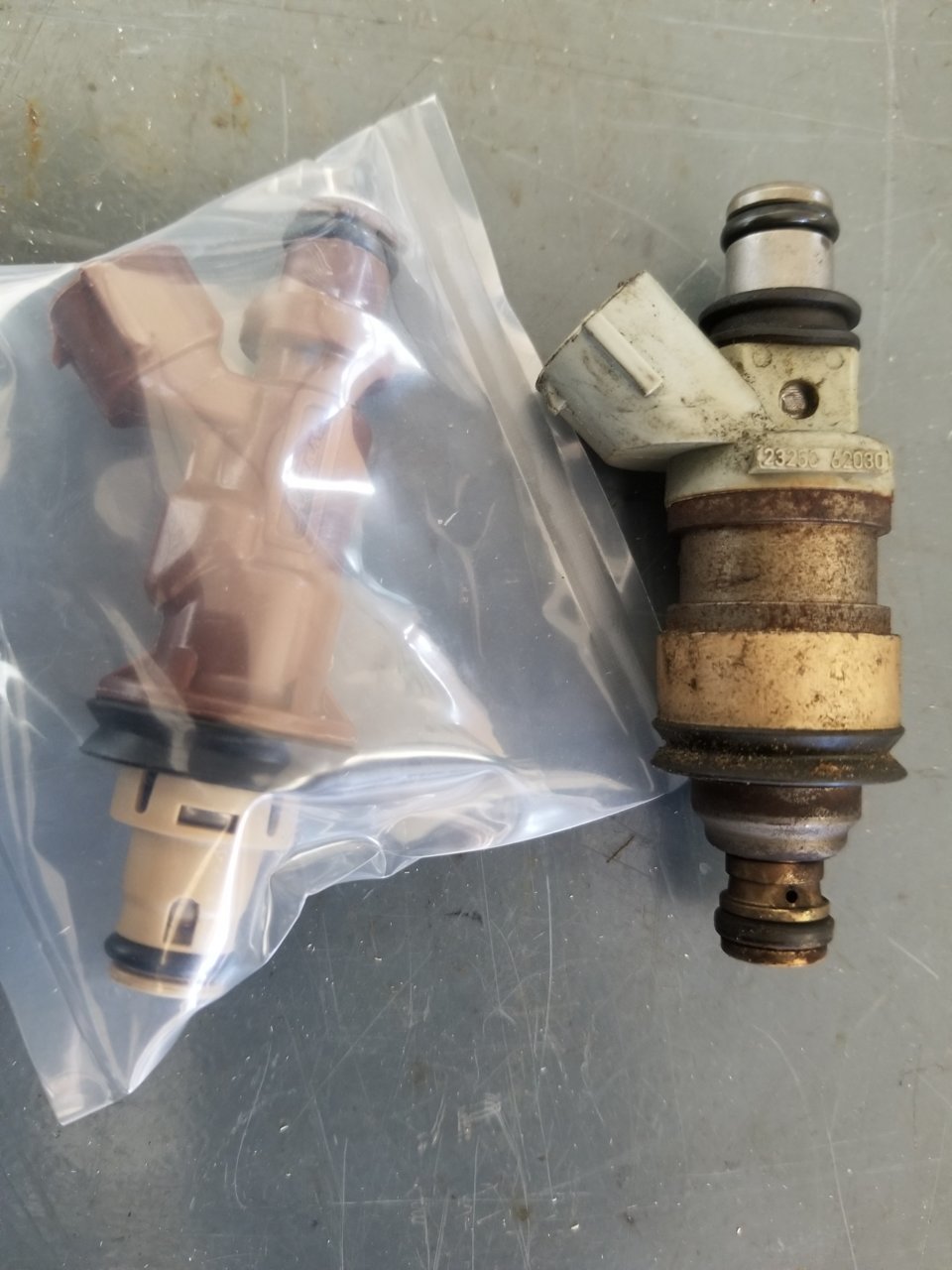

    54K just did the injectors. now I have to find the cause of high idle Looks like the injectors have been replaced before me, they dint look factory and one looked newer than others.

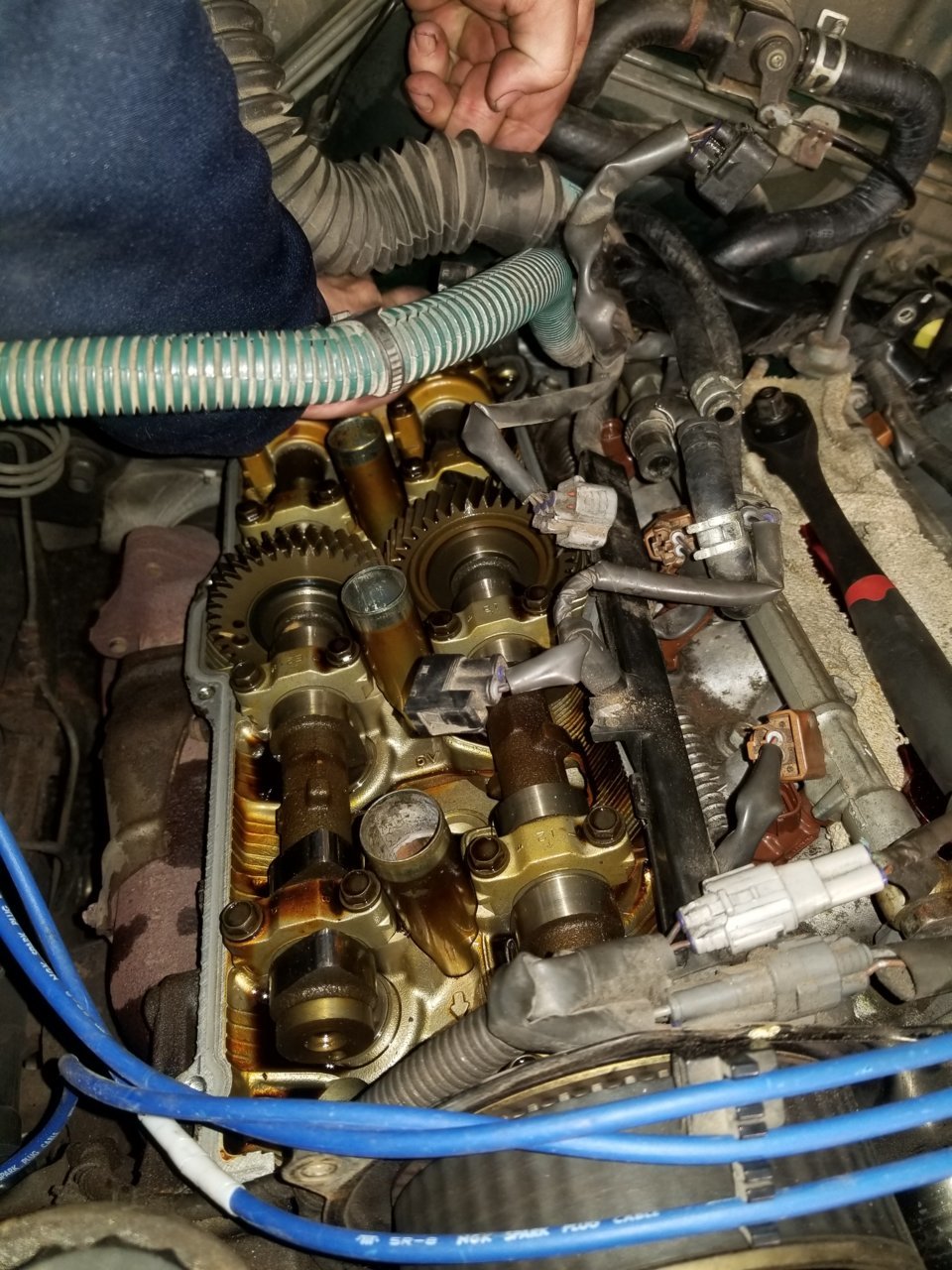

    I checked the vin with all the service records and it looks legit. I did the valve cover gaskets and the top of the heads looked really great.
    I think the truck sat a lot. Almost all the rubber had to be replaced, bushings and valve cover gaskets.
    It looks like the gas tank had been replaced from rust before. I imagine that caused the fist injectors to fail but the inside of this tank was amazing and spotless inside. From what I hear the gas sitting in the injectors and not being ran enough can cause them to go.

    Under the valve covers and the reconditioned toyota injector with one I took out20181215_194554.jpg 20181215_114132.jpg

    Something doesn’t add up, the old injector you are showning Looks wrong
    for your year 1999 and it looks like it has a million miles on it.
    The other thing strange too is if that motor as 54k on it, it should be squeak clean under
    the valve covers with little to no sludge build up.
    If you look at you spark plug tubes they are coated pretty good with a thin coat sludge.
    I replaced my motor at 490,000, The motor I have now has 200,000 miles on it and the inside looks like new still with zero build up on the spark plug tubes and almost zero build up on the heads.
    Maybe your engine is not original or a lot more miles some how, or the previous owner didn’t do any maintenance.
    Just my thoughts
    My valves below in 1st photo with 200,000 miles
    Your spark plug tubes below
