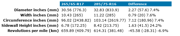

    I just upsized to 285/75-16 tires. If the stock tires were 265/65-17 how would I calculate the correct MPG due to the increased tire size?
    My thinking is that I would multiply the mileage on my tripometer by 1.07 to get the "actual mileage" I have traveled?
    from the online tire size calculator
