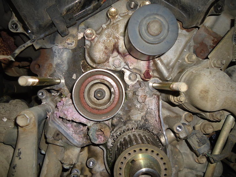

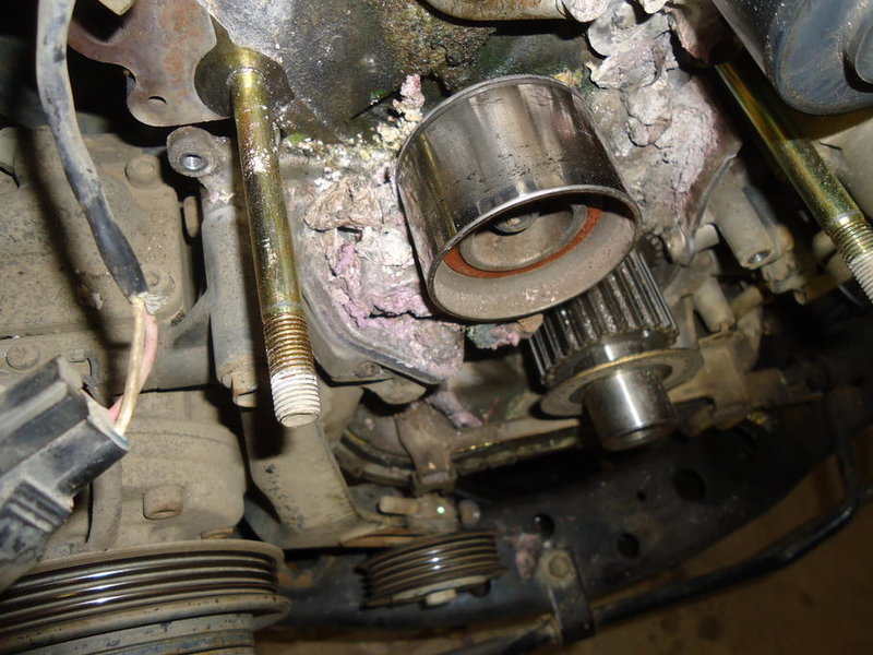

    115,300 when I changed it. The previous owner apparently just bought it, then drove it. I don't think he believed in preventive maintenance of any sort. See photos...
    These were taken when I went in to change the timing belt/water pump/all idler pulleys/hydraulic tensioner/belts/hoses--the WORKS! If you wanna see the "after" photos lemme know...

    Nice! Your waterpump had obviously been leaking for a while. That is what all that pinkish/whitish buildup is from.
    Looks like you got it just in time.
