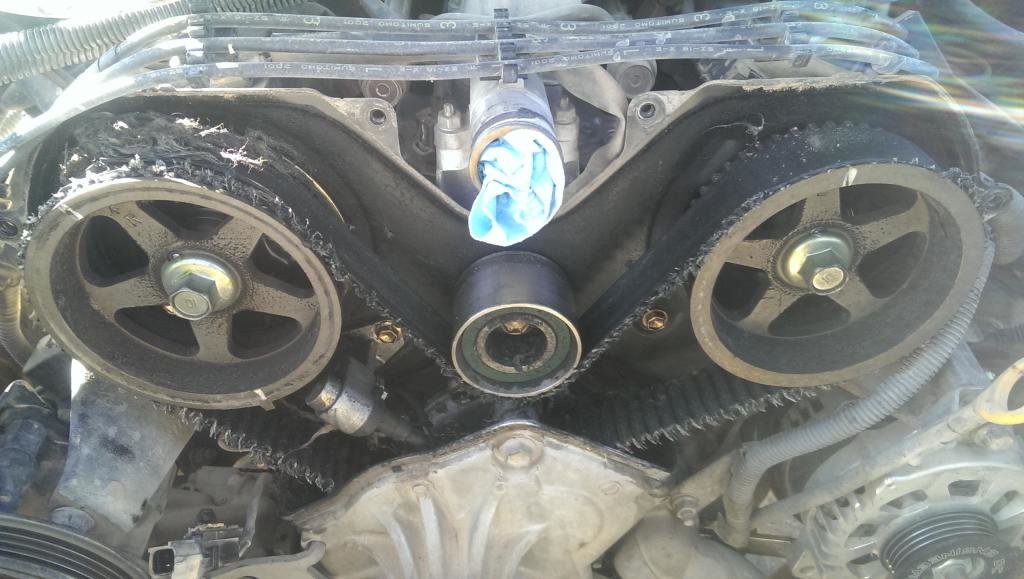

    Mm thread revival.
    Don't forget about the water pump too. mine went (water pump) at ~170k. Locked up on me driving 65mph and did this to the belt. Aircabinman kit went in after.

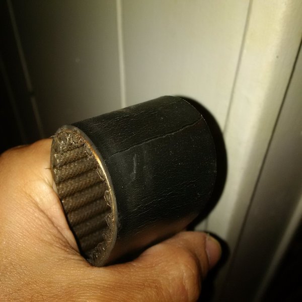

    2004 Black Tacoma Prerunner TRD V6
    180000 miles timing belt
