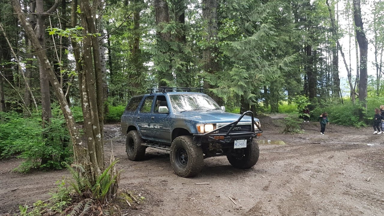

    I'll look into that headgasket issue, thanks. Tires are a non issue for me as i'd toss on my current set of 33's from my hilux while i wait for 35" things. Here's my current rig so it would be a bit of an upgrade.
