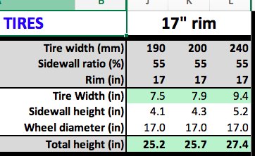

    That’s simply not true. The middle number is the aspect ratio, not a fixed value. A 245/75 has a width of 245mm and a sidewall ratio of .75, meaning the sidewall is 184mm tall. A 265/75 has a sidewalk that is 199mm tall. A 285/75 has a side wall that is 214mm tall.

    That's not how that works man. The middle number is a percentage of the tire width. A 200/50 tire is 200mm wide, 100mm tall on either side of the rim. Moving to a 400/50 at the same size rim would be 400mm wide, and 200mm on either side of the rim. That can be a big difference at the same aspect ratio. Obviously those are examples and not real available sizes.

    A 200/55 is absolutely taller than a 190/55 with the same rim.

    Hey dude, I used to race bikes, same tire measurements a 190 is not at wide as a 200 neither is a 180 vs a 200.
    The middle number is how tall the tire is
    Or do you still think a 40 series tyre is the same height as a 60?
    There is always a slight variation a 35 is not exactly a 35
    But that’s fine, been doing this longer than I care to say, I will see my self out. No need to diminish my brain power.

    No it ain’t a 200/55-17 is wider not taller,
    A 240/55-17 is even wider
    A 200/50-17 is lower in profile lower profile is a lower tyre. Or is maths wrong?
    Been racing too long to get it wrong.

    a 200/55/17 is wider AND taller than a 190/55/17......that 55 is the sidewall ratio, meaning as you go wider you also go taller if you have the same ratio
    took me a while to get it straight......@Pilsner got it right

    To bad, cause it ain’t true a 190 5017 should be the same as a 180 55 in terms of handling and height. It ain’t the 190 55 is a taller tyre than the 190 50 which also correlates to the front tyre on a bike going from a 120 60 to a 120 65
    The pic you have shows the total height which is nothing .5 is not even a real change tyre pressure negates that little bit
    Especially if the rim is the same size, it curls the tyre and flattens it out.
    A 35 12.50 does not become a 36 just by wheel size. Nor does it become a 36 simply by going to a 13 or 14 wide unless the tyre is put on a dinky width wheel.
    I’m done no here is ever gonna see the full picture so...exit, stage right.
