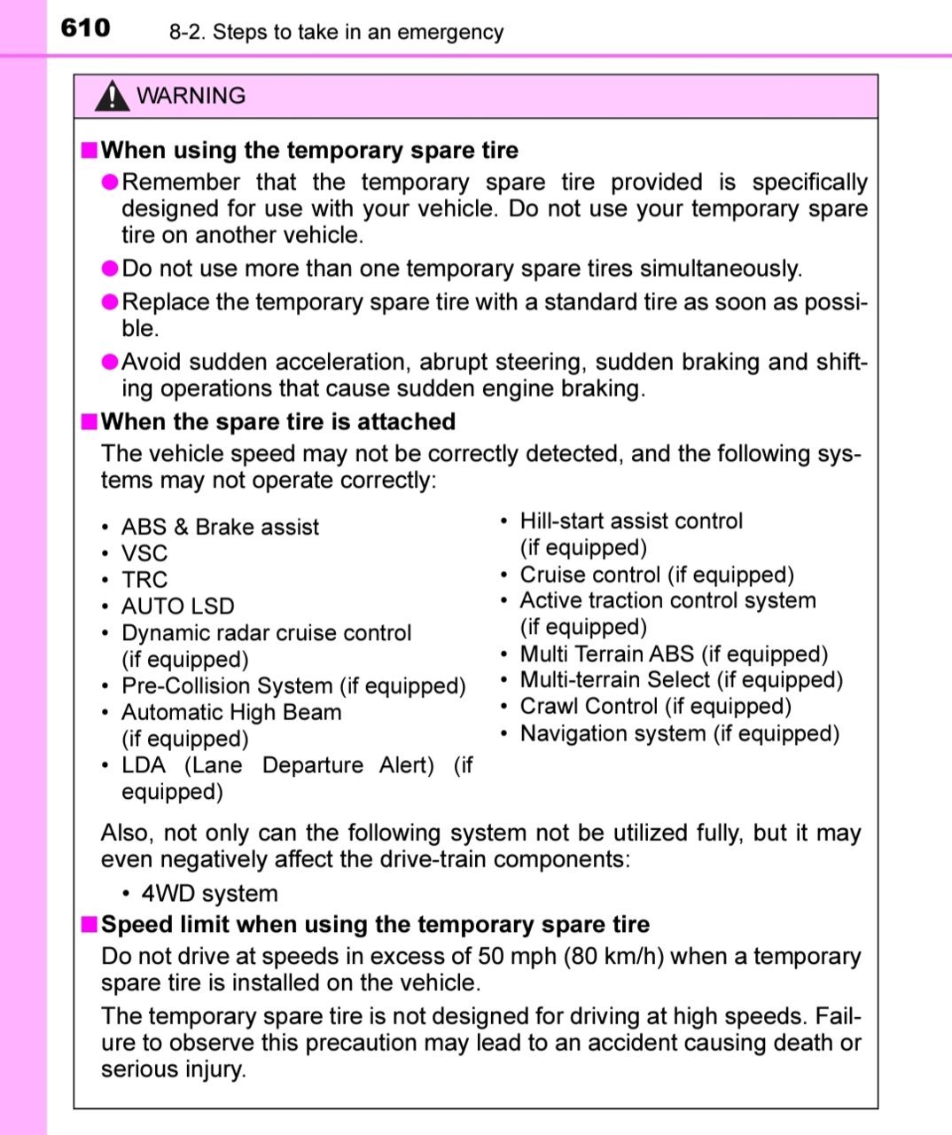

    Found this in the manual for my 2019, it even states the spare may negatively affect the drive train components in 4WD system:
  18. Aug 11, 2019 at 1:06 PM
    #98
    David K
    David K Well-Known Member
    Jun 27, 2009
    #18969
    12,421
    Pala Mesa, California
    2010 4WD Off Road DC
    Differential Breather Mod Light Bar: 4 Cree LED lamps Bilstein 5100s Ride Rite Air Bags
    A temporary spare is different than a full-size spare. Are the new Tacomas no longer coming with full-size spares?

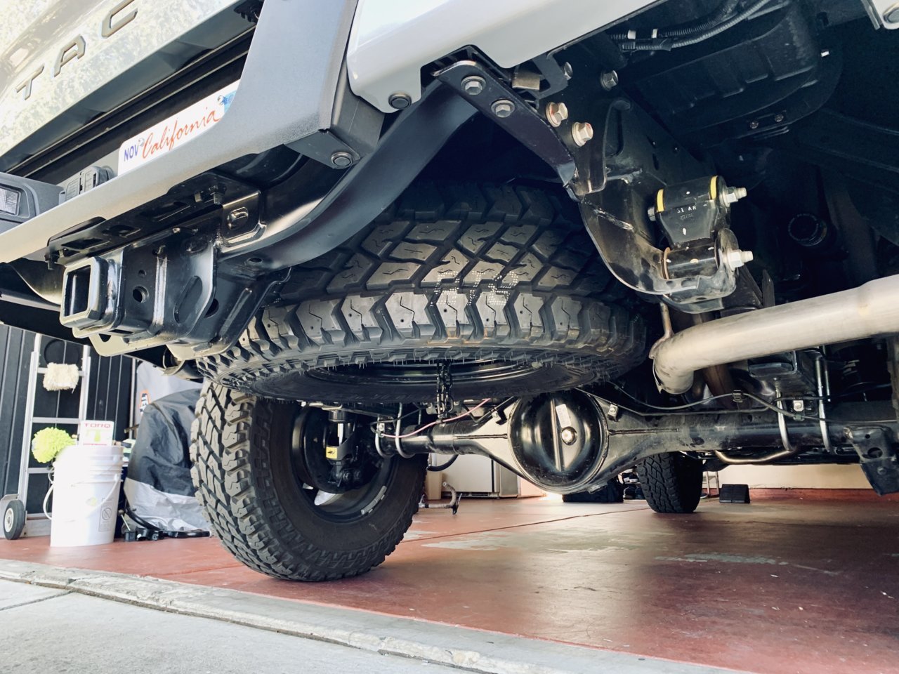

    I fit a full size spare the other week (255/80/17). Had to hammer the two brackets flat and it fit with no issue.
    Spending the extra $$$ for a full size and having the peace of mind is worth it in my opinion. The shop even balanced it for free :thumbsup:

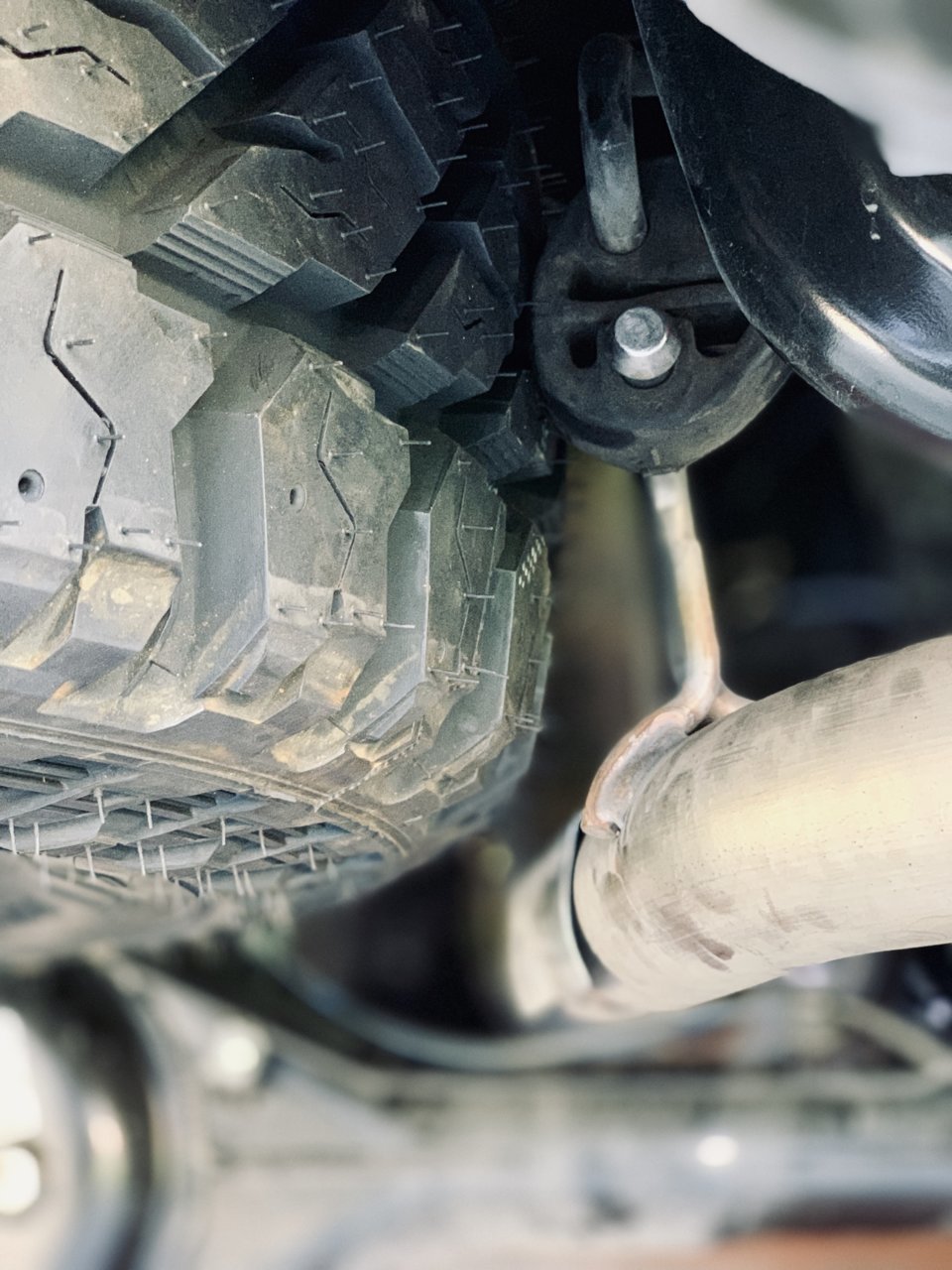

    Upsized my spare tire 285/70/17 (wheel 17" FN FX Pro). Just needed a little hammer time to make it fit under truck bed. Also the exhaust pipe was millimeter close to the tire for a year or so, I keep pushing it away but keeps coming back closer. The zip tie was a fail and I tried strong ones, still breaks understandably. Few weeks ago, swapped out the spare into the mix (balanced w/ tpms swap) and moved one of the used wheel/tire under the truck. Got all my wheels labeled from inside so all get used somewhat equally.
