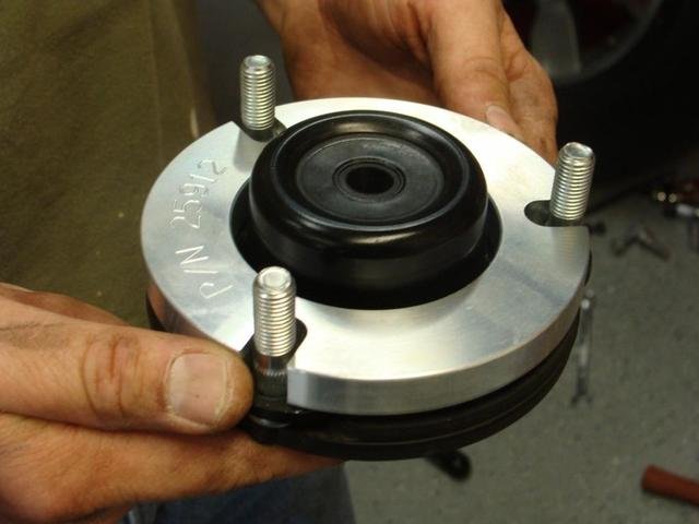

    Such a n00b question here, but I'll make it easy to answer...Is that the spacer? Does it just slide on top of the coilover assembly and get tightened down to the mount? spacer2.jpg

    Correct.
    1/4 spacer simply sits on TOP of the strut top plate.
    You don't disassemble the strut assembly to install a spacer.
    I'm running Nitros (OME) with 884s and a 1/4 spacer on the drivers side...both sides match :)
    Longer studs will be needed for spacers TALLER then 1/4...
