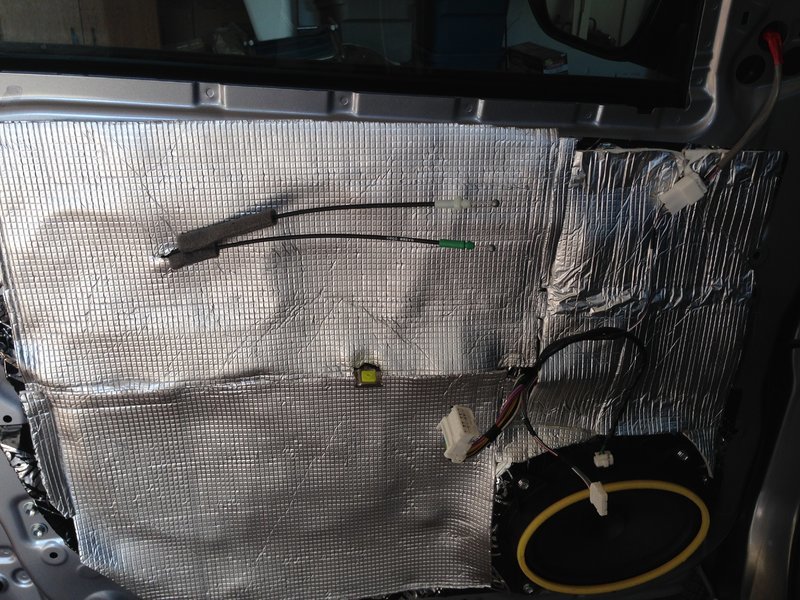

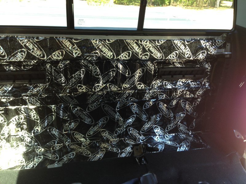

    I was wondering how much dynamat I would need to do all 4 doors and the back area behind the second row of seats.

    I used 7 sq feet for each door and 12 sq feet for the rear wall. I used around 3 sq feet for each outer skin and 4 sq feet for each inner skin.
