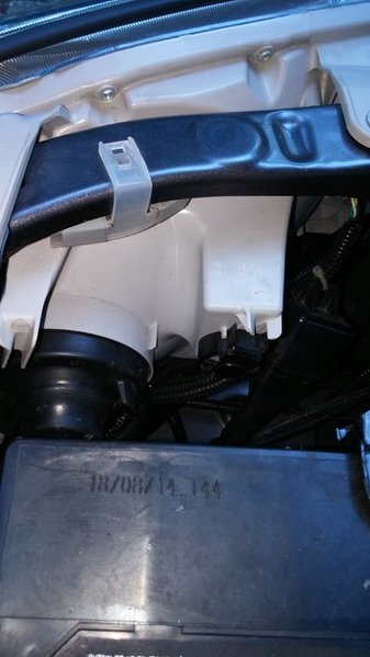

  9. Aug 22, 2015 at 12:18 PM
    #89
    6xchamps
    6xchamps [OP] Well-Known Member
    Dec 2, 2014
    #143514
    397
    Fuquay Varina NC
    2015 AC
  10. Aug 22, 2015 at 12:19 PM
    #90
    Justus
    Justus fucks not given
    Jan 4, 2013
    #94417
    9,230
    Nabisco the kid
    In ur toolbox
    not so low, not so slow 2006 6 lug
    stockish
    I don't know what to say about the shop u took it to tho lmao.
    That's kinda scary
  11. Aug 22, 2015 at 1:45 PM
    #91
    6xchamps
    Dec 2, 2014
    #143514
    397
    Fuquay Varina NC
    2015 AC
    Not seeing those screws to adjust on the 2015 though

    Perplexing....... Wish I had a 15 to take pics of..... U don't see ANY gear/screw type adjusters?
  14. Aug 22, 2015 at 2:27 PM
    #94
    Justus
    Jan 4, 2013
    #94417
    9,230
    Nabisco the kid
    In ur toolbox
    stockish
    u dont have these two phillips/gear head adjusters?
    11 o clock and 5 o clock positions (using the dust boot as center) in pic

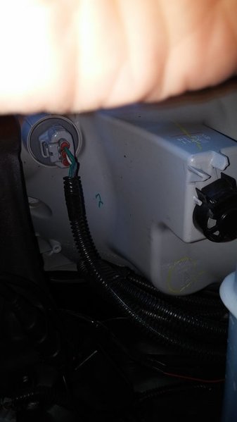

  15. Aug 22, 2015 at 2:54 PM
    #95
    6xchamps
    Dec 2, 2014
    #143514
    397
    Fuquay Varina NC
    2015 AC
  16. Aug 22, 2015 at 3:06 PM
    #96
    Justus
    Jan 4, 2013
    #94417
    9,230
    Nabisco the kid
    In ur toolbox
    stockish
    yup, remove those black caps, slide long philips screwdriver thru those slots, turn, watch beam against wall to see what way to turn
