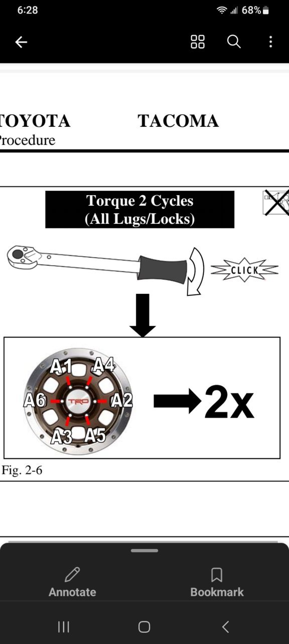

  11. Mar 6, 2023 at 4:32 PM
    splitbolt
    splitbolt Voodoo Witch Doctor
    Mar 7, 2010
    #32761
    7,858
    NW Arkansas
    2016 TRD OFFROAD DCSB MGM
    Also...which pattern do you use for 6-lug?
    This?
    Or, this?
    Found this in the Fox TRD suspension instructions...
  12. Mar 6, 2023 at 4:36 PM
    Bishop84
    Bishop84 Well-Known Member
    Dec 17, 2015
    #172494
    11,697
    both, I do pretty much the pattern shown
    I impact with a torque stick for one big reason. Incase I forgot to torque with the wrench.
    2 million tire rotations I need redundancy.
    I never forget, but it’s nice to know it can drive away and I’m not going to lose my job lol
    I don’t use sticks on high end rims. But I rarely see those anymore
    HondaGM and splitbolt[QUOTED] like this.
