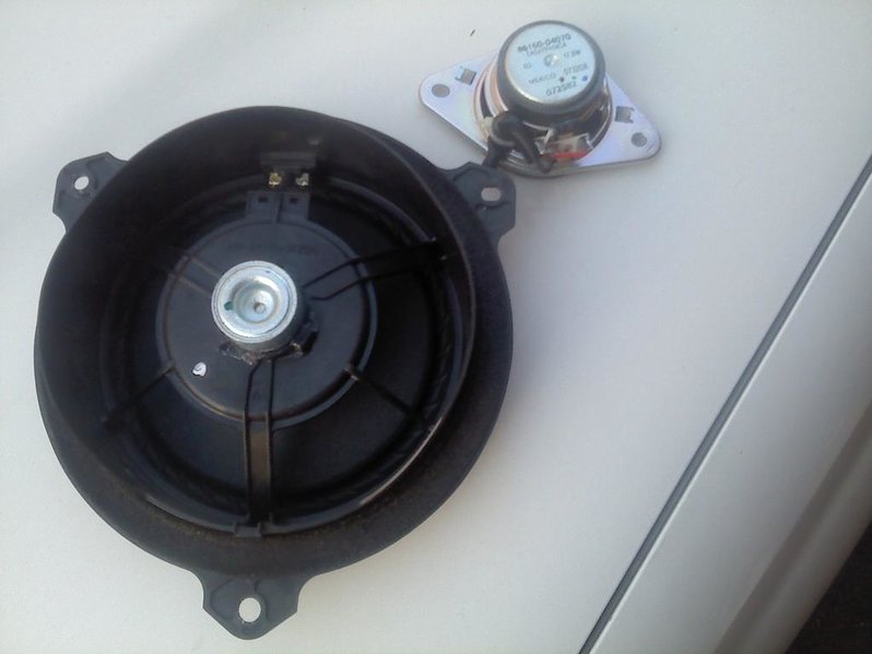

    Just swap it out.
    There are conversion kits for the 2012 dash... no hacking required, it's plug and play and you'll be done and listening in 20 minutes or less.
    Base model HU's problem is not wattage... well... yes, that's part of it... but the bigger problem is the EQ is set to avoid blowing up the shit speakers that Toyota graced us with.
    I'm attaching a photo of the stock speaker... but remember that the problem with the sound is the HU. An aftermarket HU will make these speakers sound pretty damned good, right up to the point that they toast.

    Wow, look at the magnet on that sucker!!

    The tweeter can lift the main speaker.
    The main speaker can not lift the tweeter.
