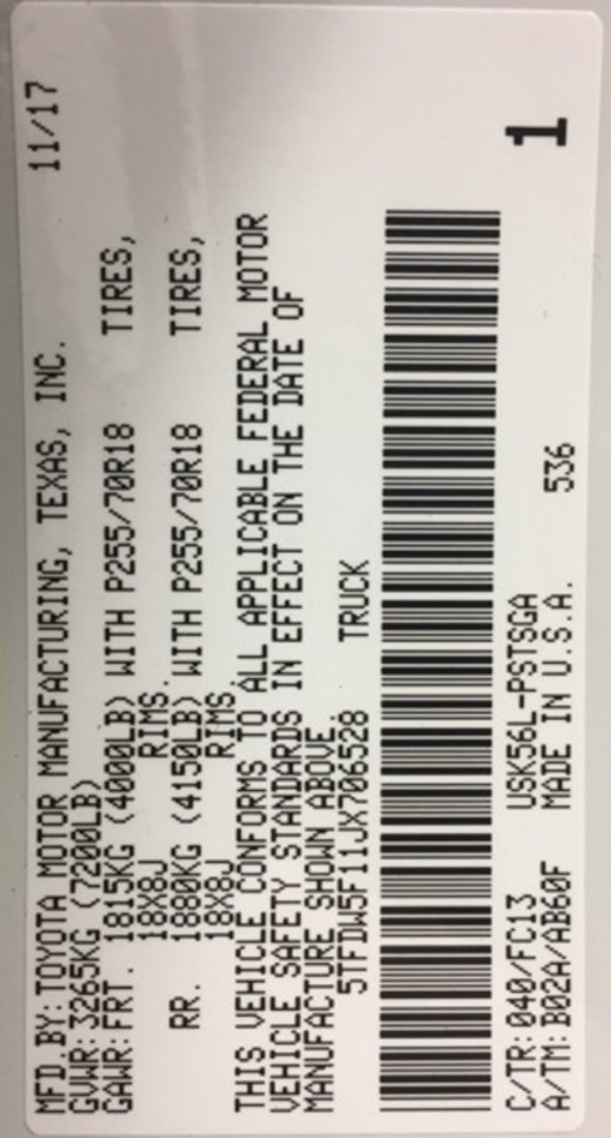

    Tundra, Ohhh! I was curious at the 7200 GVWR.. In other good news OP, looks like your truck was made in Texas! :oldglory:
