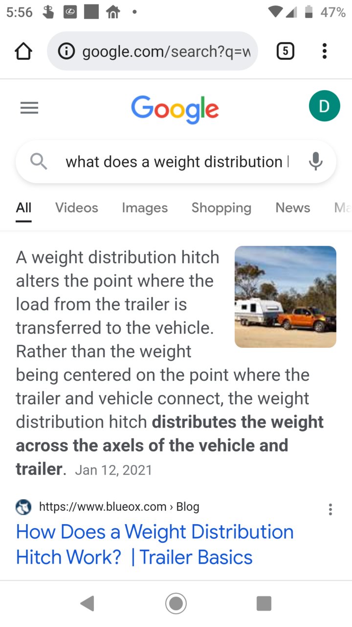

    Weight distributing hitches equalize the load evenly on the frames between the towing vehicle and the trailer and definitely reduce the load on the ball: accomplished by hitch chain on a hook you adjust, connected torsion bar(s) between the two vehicles, and traditionally an analog, lever-adjustable friction sway control brake included in the mix. When it is set correctly, the result is a level tow at the ball: no rear sag on the tow vehicle, no downward dip on the trailer hitch frame on the ball. i.e.: the weight on the ball is shared distributed/evenly by the frames of the two vehicles.

    Maine says 3000# brakes on all wheels. My electric trailer brakes work just fine at any speed you maybe thinking surge brakes. Yes a WD hitch is a big help. My 2011 Tacoma has the tow package I don't know about the newer ones but under the "harsh ride" I made Toyota replace the rear springs guess what it had another leaf in the spring pack. My camper loaded is about 3500# and 17' with brakes on all 4 wheels I have no doubt I could pull 10,000# but I'm sure as hell not going any where on a public road with it. 3/4 of a ton is not a not a "little" added weight would you put that in the bed of your 1/2 ton truck?

    45% more is not much more... 5100lbs is over the weight of the truck.

    A WDH distributes the weight between the tow vehicle front and rear axles. It keeps the steering from getting squirrely.

    Spot on explanation that last post on hitches and clearer than I was trying to explain it. Thanks for posting it!
