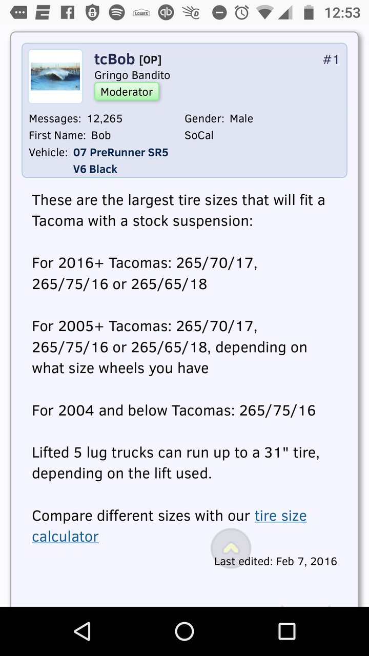

    I've got an 'O7 and thinking of upsizing to 235 75R15s...
    Has anyone had success with that or larger without fitment issues?

    Thanks, ChemDawg. Checked out the link... Says 265 60R16 will fit...
    I thought sizing for Tacomas depended on which model it was (ie., 4x4 models could handle larger tires than 4x2 models).
    I definitely don't want or need to go up to 265s or even 245s...was just looking into 235s to open up some all-terrain tire options...not much available in 215s...
    Guy at Costco tires is saying he's not sure 235s would fit...he's been there for 20 years... maybe he don't know jack, but I would think he would have come across this issue in his 20 years there... maybe not.
    Anyway, all they have in 215s are BFG KO²s LT metric... which would be fine except for the fact that our Taco is a daily driver and we are getting ATs mainly for a trip down to Baja... concerned that, while bulletproof, the LT BFGs will be uncomfortable as hell... Someone please correct me if I'm wrong.
    That's why I was looking into something like Falken AT3Ws in 235s...p-metric and $65 less per tire....
    Thought I would post this for advice in the 4 cyl forum as it seems like most people in the Tire/rim forum are working with 6 cyl. 4x4s.
    Any and all feedback greatly appreciated.
