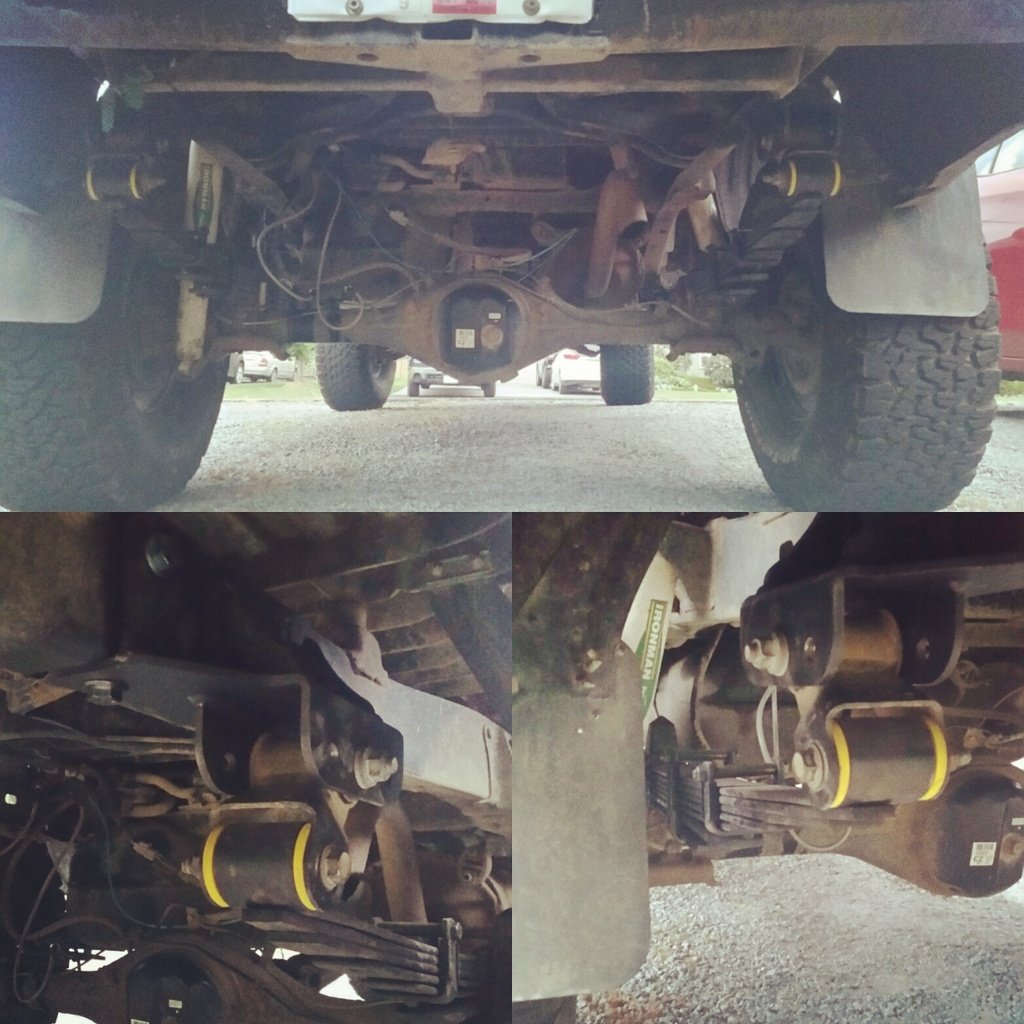

    I'm running close to the same weight, at 5740 lbs on the most recent check, but just ordered the D29XL to see if that makes a difference. I have to keep about 25 - 30 lbs in my air bags to keep the truck level. Otherwise, no air to 5 lbs or so in the air bags the rear end will drop 1/2" - 1" with the standard Dakar leaf pack. I'm hoping the add a leaf will lessen the amount of air that I have to keep in them. Some questions on the add a leaf though; what order does the new leaf get placed, ie between top leaf and leaf #2? Standard length u bolts that came with the Dakar pack are long enough? I'm planning to install longer brake lines, but haven't wanted to mess with that project yet.

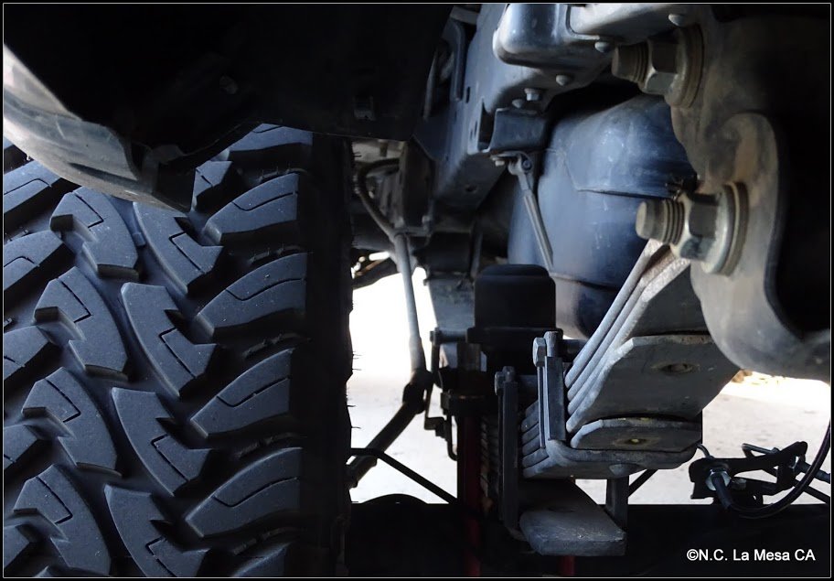

    I have the overload in mine.
    I love the Dakar spring Pack. I don't recall any settling. These days I'm running 250lb over stock, in the bed for daily driving. :)
    No shocks required. :thumbsup:
    j/k on the shocks! :D
