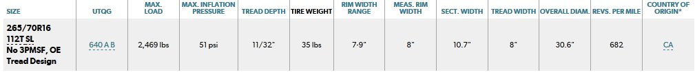

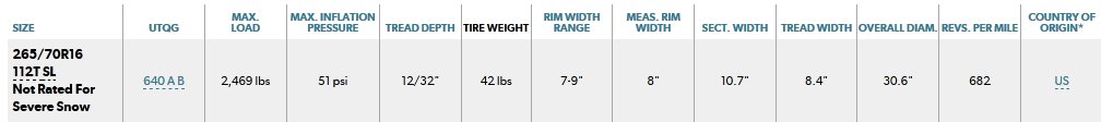

    The stock version of the Goodyear’s are only 35 lbs, so you gained 10lbs with the Duratracs.

    2018 DCSB TRD 4x4 OR
    I had to search for it but I've seen the goodyears in that size listed at 42 lbs as well on tire rack. Now I see the Toyota OE style listed at 37 lbs on discount tire. Now I'm curious so I'll have to measure my old spare

    BadKitty Well-Known Member
    Dec 3, 2016
    #203937
    333
    Indianapolis
    2017 Black Tacoma TRD-offRoad 6spd
    TRD Intake, TRD exhaust
    Im confused about this as well...
    12/32 @ 42lbs
    11/32 @ 35lbs..
    I find it almost possible to believe 1/32 of an inch on a tire or white lettering is responsible for a massive 7lb difference..

    Navigator1
    Navigator1 Assistant to the Regional Manager
    Mar 29, 2018
    #248850
    1,272
    Spokane WA
    18 TRDORDCLBCEMENT
    It’s .4” narrower too. Probably lighter weight plys too if I had to guess.

    splitbolt
    splitbolt Voodoo Witch Doctor
    Mar 7, 2010
    #32761
    7,858
    NW Arkansas
    2016 TRD OFFROAD DCSB MGM
    The Canadian-made is the OE tire.
    The OE sidewall is ridiculously thin.
