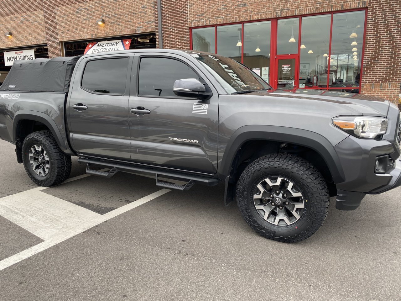

    I just went from stock 265/70/16 Wrangler Kevlar’ as
    That had 4/32nds left on the tread to the Falken Wildpeak At3ws. It went from 37 lbs to 43 lbs per tire and my truck feels like I’m driving through sand. It’s slow to initiate turns, takes longer to stop, and my foot is getting a work out keeping the pedal down more. There has to be something to the weight issue. I get that 37lbs is light, but I think I’m going to return these for the Toyo Open Country ATIIIs to save two pounds and hopefully get some better performance.
