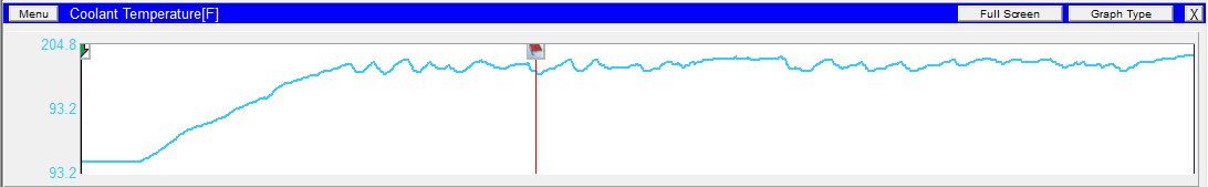

    What type of engine temps are you seeing? I have the 3.5 auto and am pretty heavy.
    I see mine fluctuate between 186 - 202 all the time. While I am driving. For no apparent reason. It does not matter (much) if I am going up, down, or flat. It will vary between these numbers nearly constantly. It will hold sometime for a couple min, but then it will vary again. I am using a scan gauge II to monitor.
    Makes me want to put in a new thermostat... 22K miles.

    Engine temperature fluctuations are completely normal. They can change based on load, ambient temperature, air flow across the radiator, heat load from the other sources (trans, pw steering). The sensor isn't always as accurate either. It can fluctuate too.
    Another thing to note is thermostat operation... the set temperature is the point that the thermostat starts to open. And then it it will open and close as needed to maintain that temperature point.
    I wouldn't worry too much about the temperature reading and be more aware of the signs of true heat shedding issues, like the fan clutch engaging when clearly not required or coolant boil over. There is a reason the temperature gauge on the dash doesn't have numbers, makes people worry unnecessarily.

    You want to put in a new thermostat because it's functioning as intended?
    The internal combustion engine that powers your truck harnesses a small explosion in each cylinder. Said explosions produce heat.
    The cooling system, that came factory on your truck, cools the engine down.
    With your given values, when the temps are 184°F or below, the cooling system turns off. When it reaches 202°F, cooling system turns on and brings the temps down to 184°F or below. This cycle repeats over and over.
    180°F-210°F is a very normal operating temperature range. If you're 215-220°F+, you might have a problem.
