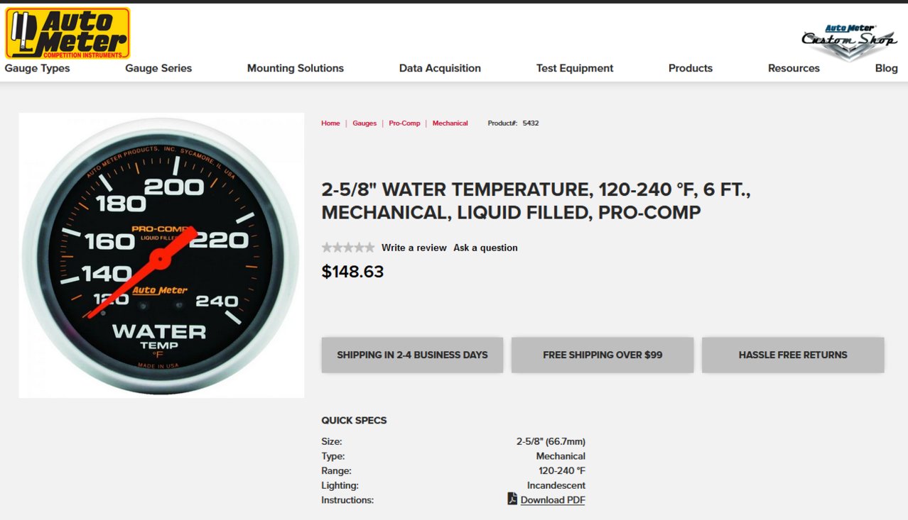

    I did a mild build on the stock 20R for my first off-road truck. 1979. I had the below (or maybe a model or two older but the direct replacement) gauge. I had a whole suite of nice gauges in that truck... BUT, the first thermostat I had in it was too hot, maybe around 200. It would swing maybe 5-10 degrees. I switched out to a 180 and from then on, no matter what, it ran almost exactly 180. Needle barely moved out of the white line on 180. It was fun to watch the engine heat up and the thermostat open and it stable out to 180 and STAY. I know it had to cycle the thermostat open and closed to maintain this, but it did it so very well. This swing on the 3.5 seems dramatic compare to my one and only comparison. This is the only other engine I have had a quality gauge on that is high quality and accurate.
