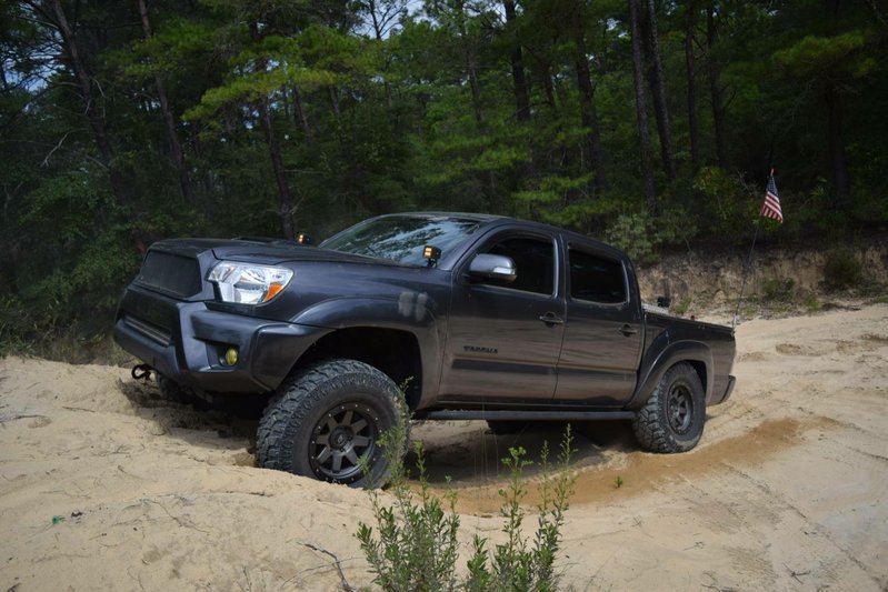

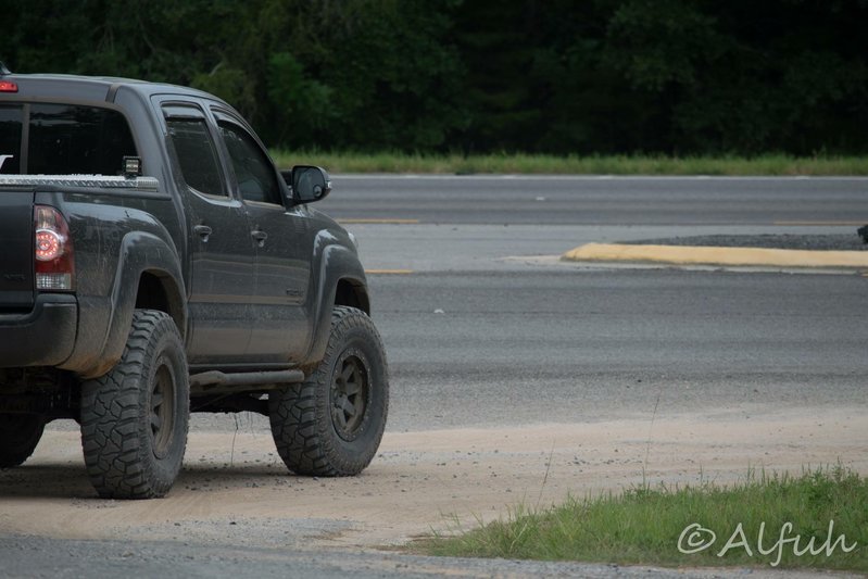

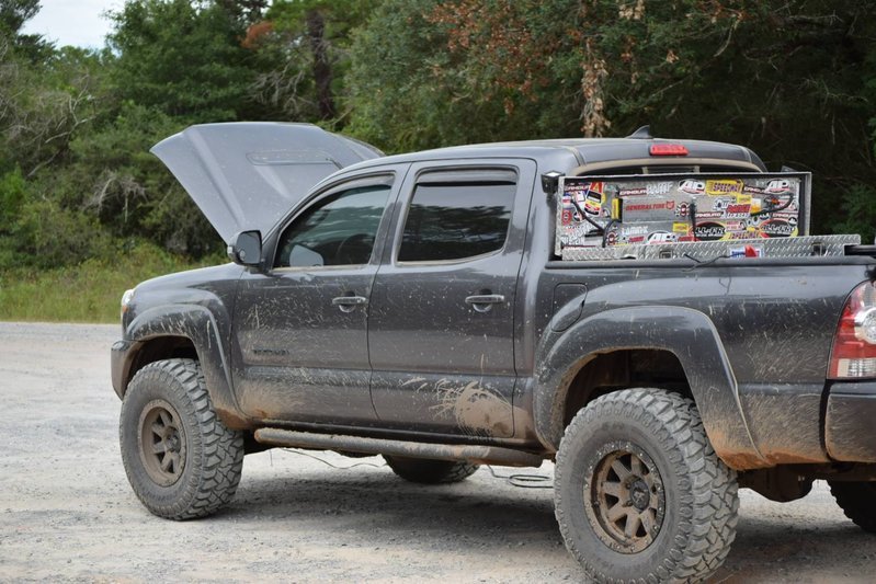

    That's what I did and couldn't be happier.
    Bilstein 5100s
    OME 885 coils
    Add A leaf
    This'll run you like $650-$700 from Headstrong Offroad and will ride like stock.

    The bilsteins are set at 0. I had 5100s in the rear as well to accommodate the lift. As far as the AAL, it doesn't matter which one. The main difference is a single AAL vs a 3 leaf progressive AAL. The 3 leaf rides smoother, but costs more. I had the single and was fine.

    Nope. Stock ones and it aligned fine.
