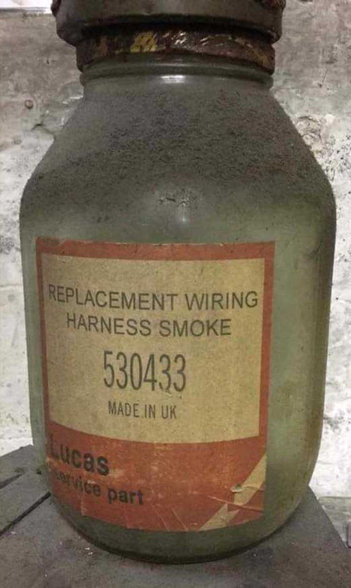

    Anyone familiar with british cars is already living this joke (the electronics are soo shitty):
