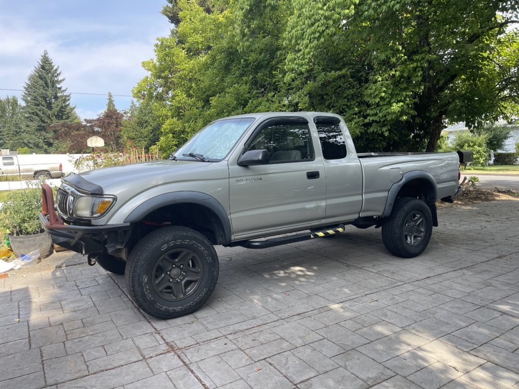

    I’ve been fixing up this old 2001 2.7 L Tacoma I’ve had since I was a young man lol
    All the suspension and steering components has been replaced, Upper control arms are from JBA. Extended travel CV axles from rock auto. Has a diff drop, and drive line spacer.
    I used 882 springs and 5100 shocks in the front (lowest spring setting). In the back 5100, and Progressive leaf pack along with new HD general spring leafs. Trail gear tube bumper in the front , no winch installed.

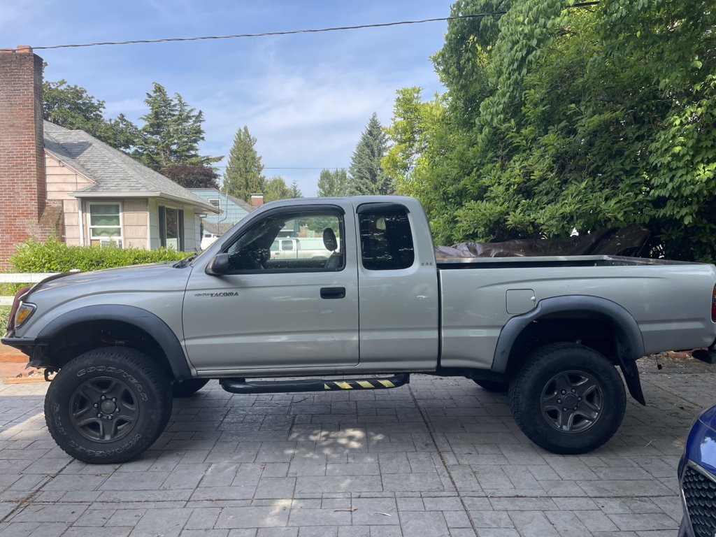

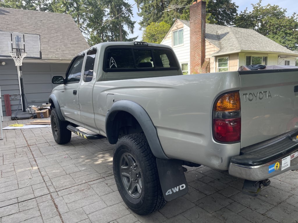

    I’m using the stock tire size and from top of wheel well, I’m measuring 37 3/4 on the driver side and 38 1/2 on the passenger side off the ground. I really don’t know what I started with. I used ChatGPT and it tells me I have between a 4 inch and 5 inch lift, which was hard to believe. The rear sit about 1.5 inches taller than the front.
    My question is how much lift is this? And the only thing left is reinstalling my sway bar, Does it need a drop kit of some kind? This truck will mostly be on the street, But would one day like to take it up some easy trails. Nothing crazy. Stock tires!
    After I got it all back together, including new, lower control, arm bushings. The truck drove straight as an arrow, and all of the bump steer was gone.

    Every truck is a bit different so it’s hard to say how much lift you actually have without comparing directly to your old setup.
    I’m running 265/75/R16 AT4/W’s and my truck sits at about 37.5” with Fox 2.5s up front. I believe I’m at about 2.5” of suspension lift from stock.
    That 4-5” that ChatGPT gave you probably includes tire height as well.

    I don't think anybody can accurately tell you how much lift you got over your previous setup. Only you could have known, had you measured before and after install of the new suspension. In all honesty I don't know what value that number you're looking for is going to provide anyway.
    To answer your other question, no you shouldn't need a sway bar spacer. I've run up to 3" of lift up front without one and had no issues. If you are running more lift than that up front, then you're likely to experience bigger issues than sway bar fittment.
    Bigger tires would really look good on that thing.

    You can "guestimate," the stock height of the front is between 20 and 22" or so. Mine settled in at 21" stock, 21 1/2" right after front end refresh. Measure from the center of the hub to the underside of the wheel well. So your lift would be anything above 21".

    Okay, so my measurement on the driver side is 24" and the passenger side is 24.5". So right about 3" lift. Thank you everyone for the tips!

    looks like around 3" to me
