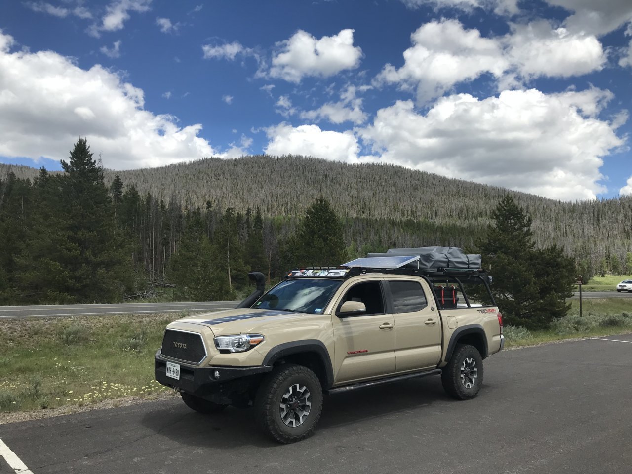

    The 2” lift rating is at full load on the springs to the best of my knowledge.
    Picture is of my truck fully loaded and tipping the scales at 6800lbs. They handle the load like a champ and still flex and function well. Truck sits dead level loaded out like this. 886 front coils and Dakar heavy rears.A0926252-C67F-4DDE-85B6-D7E403FA5546.jpg

    6800 lbs? Over 2000 lbs above stock. How did you manage that?
    Edit: Nice test of capacity engineering. Kinda glad to hear that the Taco can handle being overloaded.

    Sliders, skids, bumper, winch and bed rack all built out of steel. Six E rated 265/75r16 KO2 tires, two auxiliary batteries, solar panel, solar charge controller, auxiliary lights, auxiliary equipment wiring ect. Recovery equipment, tools, chainsaw and fuel for saw. 18 gallons of auxiliary fuel, 21 gallons of fresh water. On demand water heater, pump and shower setup. spare CV shaft, spare u-joints, spare filters, various other spares and fluids for all components. Camp kitchen, fridge, camping gear, first aid/trauma kit roof top tent, shovel, hi lift, awning, roof rack and associated hardware. Throw in my 95 lb wife, my 85 lb dog, 200 lbs of me our clothing, fire arms and ammunition... you get the point it adds up pretty quickly.

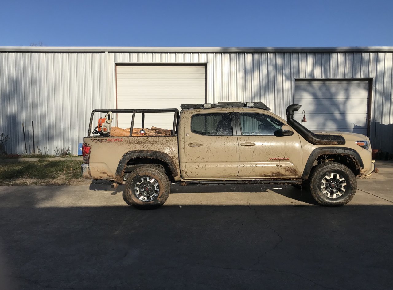

    Just under a face cord of wood saw and other wood cutting tools in the bed.FDADAF02-537C-465C-BB46-054F31A02344.jpg

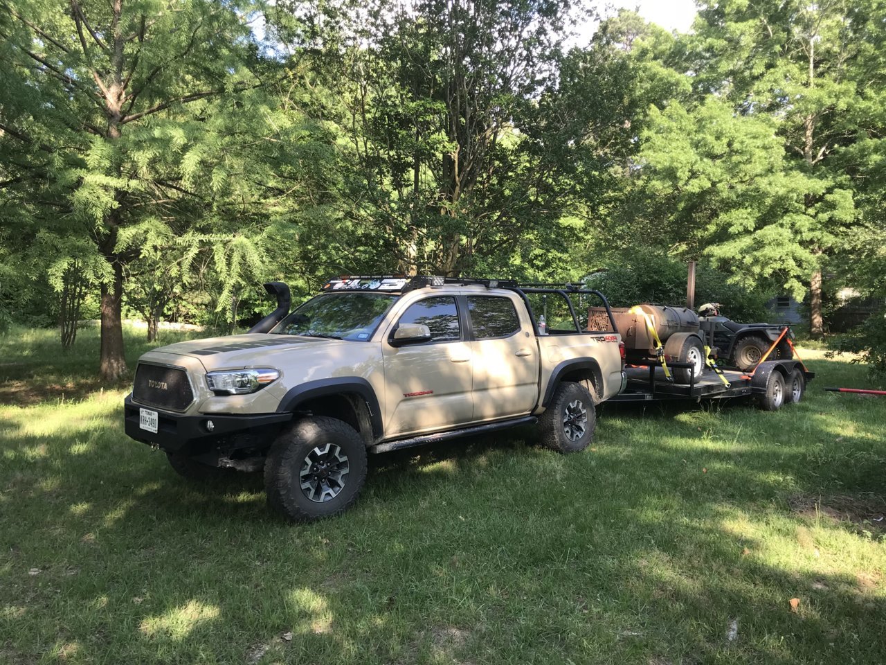

    Half a face cord of wood in the bed, trailer, smoker, 4 sheets of 3/16” steel plate(stacked on trailer deck under 4wheeler), Honda 500 and my normal tools and junk I haul. A8983DEE-3A10-491A-AC7E-0A21FD7DB88C.jpg
    The OME suspension parts/systems work good and hold up well. The Tacoma can handle more than you think too. Just make sure you do some upgrades to your brake system. The go is not an issue it is the stopping where people get in trouble.
