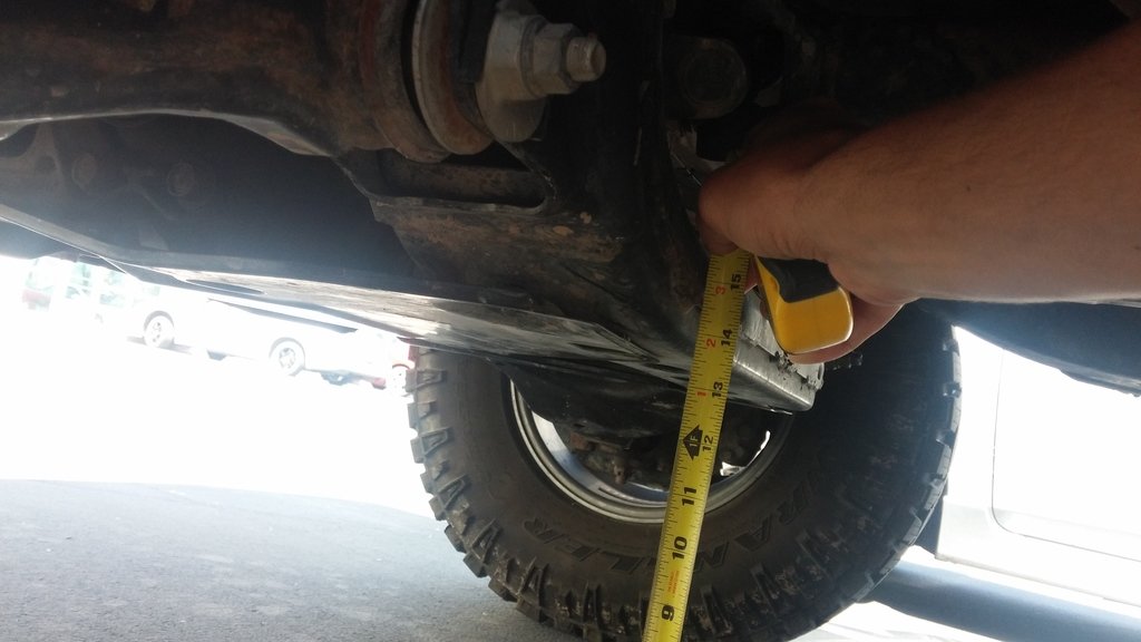

    I originally purchased my 2007 DCSB Tacoma used with 7k miles, equipped with a spacer lift. I quickly changed the spacer lift out for a Toytec Adjustable CO kit, built with Bilstein 5100s and put 285s on the truck.
    Fast forward to now, 100k miles later, and I just purchased a set of Bilstein 6112s to swap on. I'm trying to determine how much lift my truck currently has so I can closely match it with the 6112s clip grooves. I can obviously guess my way into this by just placing the clip on the 5th groove, but I'm trying to decide if I should order 1/4" or 3/8" top plates to have ready for when I go to install. Any insight you guys could provide would save me time at install.
    Here are the measurements that I can easily grab. If y'all need more information, I'll do my best to provide it.
    Driver's Side:
    Ground to fender (measured vertically through the hub center): 38.875
    Ground to hub: 15.5
    Passenger's Side:
    Ground to fender (measured vertically through the hub center): 39.25
    Ground to hub: 15.5
    Center of vehicle (ground to frame): 13.75

    Hub to fender should be my two measurements minus the 15.5" ground to hub, so:
    Driver's side: 23.375
    Passenger side: 23.75
    That's a very difficult measurement for me to obtain since my tires flare outside of the fenders slightly.

    Thanks for the help. I'm probably a bit over-extended on the passenger side. I do have LCA rubbing on the passenger side (turning in reverse), and it may be attributed to this.
    I just ordered a 1/4" and 3/8" top plate spacer so I can dial in the lean. Perhaps I can even take the 6112 down to the 4th setting to take some load off the springs.
