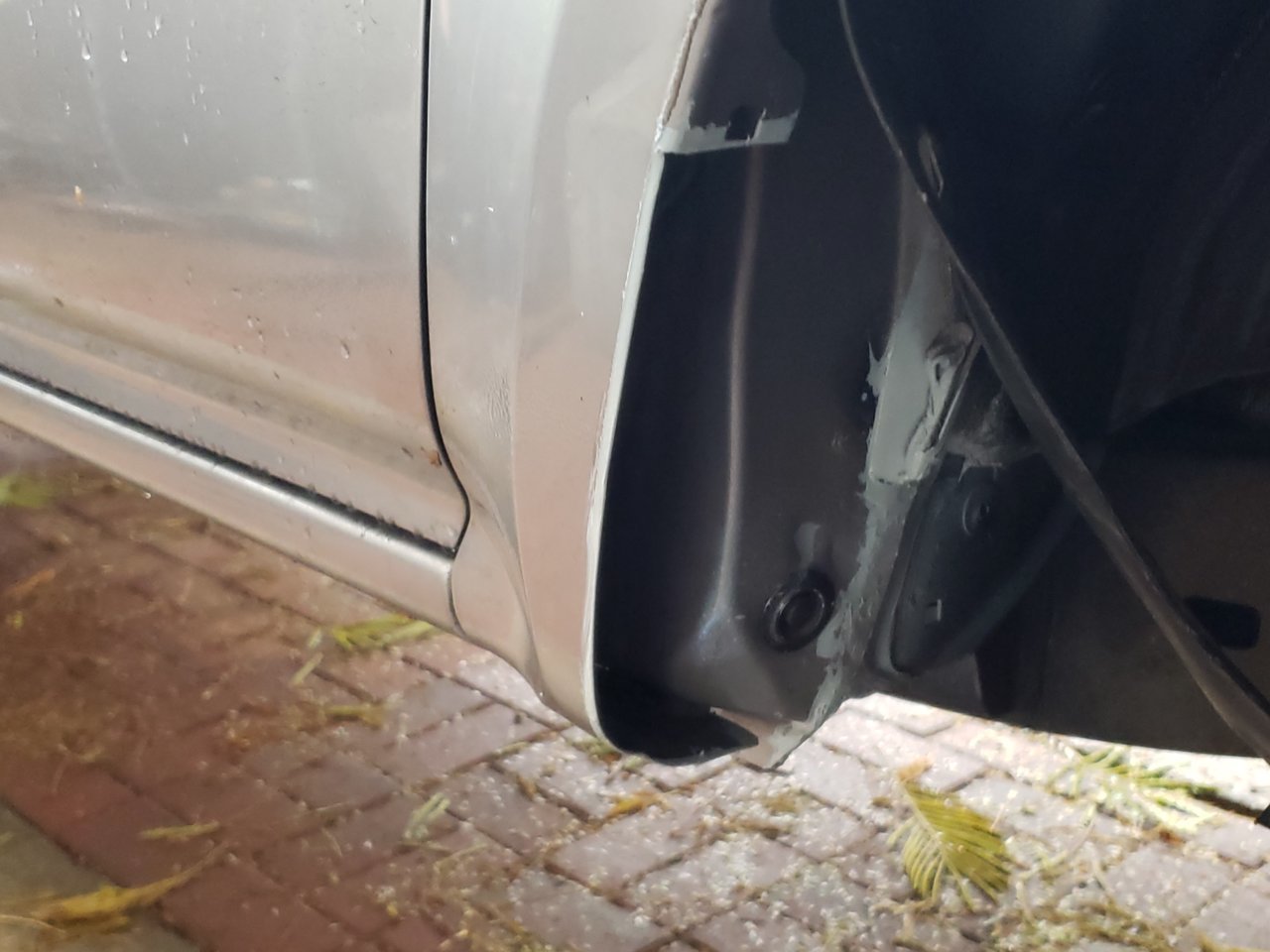

    I run 33x12.5x15 on mine. I run 2.5 front lift (until I blow a uvjoint) and 3.5 rear (cause tools are heavy). 4Wheeler called after putting the tires on and told me about the bumper and pinch welds which I knew had to be done. I told them I'm hopping on my bicycle and if it's done I'll pay the 40 bucks or I had already planed to do it myself. They got it done.
    Everything fine in the mountain trails where you go slow but as soon as I went to Oceana Dunes in Cali doing 30+/- mph I cut my fenders and installed the bushwackers. I was also concerned about throwing mud and rocks as I have worked in some mud pits before so I had been looking at fender flares since before I lifted it.
    the front passenger side
    jackn7 likes this.

    It looks good! Nice job. Now take some black undercoating to cover that up and blend it all in and you won’t even notice it.
