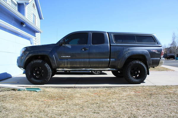

    Toytec ULK; OME Dakar leaf packs; Light Racing UCAs; OME carrier bearing drop; Toytec 3 degree axle shims; Toytec sway bar relocate kit; Toytec extended rear brake lines; ARE CX topper; BAMF rear differential skid; BAMF LCA skids; BAMF sliders; Budbuilt IFS, mid, transmission, and gas tank skids; HomerTaco mesh; River Rat 69 satoshi grille; Toyota Land Cruiser radiator grille emblem; tinted windows; Toyota all-weather floor mats; Toyota bedmat; I-Pod interface; block heater; ATO hi-lift bed rail mounts; HL-605 Hi-Lift; RotoPax 4-gallon gas can and bed rail mounts; mattgecko sliding window security bar; Sockmonkey decals.
    Here is mine with a ToyTec ULK and the Dakar pack w/out the overload leaf.
    Justin

    looks good i just bought the walker evans racing front coil overs off here also will the OME give me 3 inches?
    Mine gave me 3 1/2-3 3/4" with a +200 lb topper. Without a topper, I would assume it would give you 4".
    Stock:
    Left Rear at 21 1/8" Hub to Fender
    Right Rear at 21 1/4" Hub to Fender
    Dakars:
    Left Rear at 24 5/8" Hub to Fender = 3 1/2" H/F
    Right Rear at 25" Hub to Fender = 3 3/4" H/F

    Really. Those measurements were taken a few months ago when they were first installed. They may have settled some by now.
