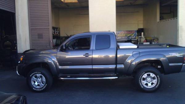

    can someone explain to me why the Ome 885's with 5100 billies aren't yelding the 2.75 or 3 inches on a 4x4 ac when the double cab seems to weigh more. I installed mine goin frombillies set at 2.5 to omes and billies at stock but looks nothing like what people are saying

    did you add the top plate spacer? you're looking pretty stock there on your first pic. second pic looks about right
