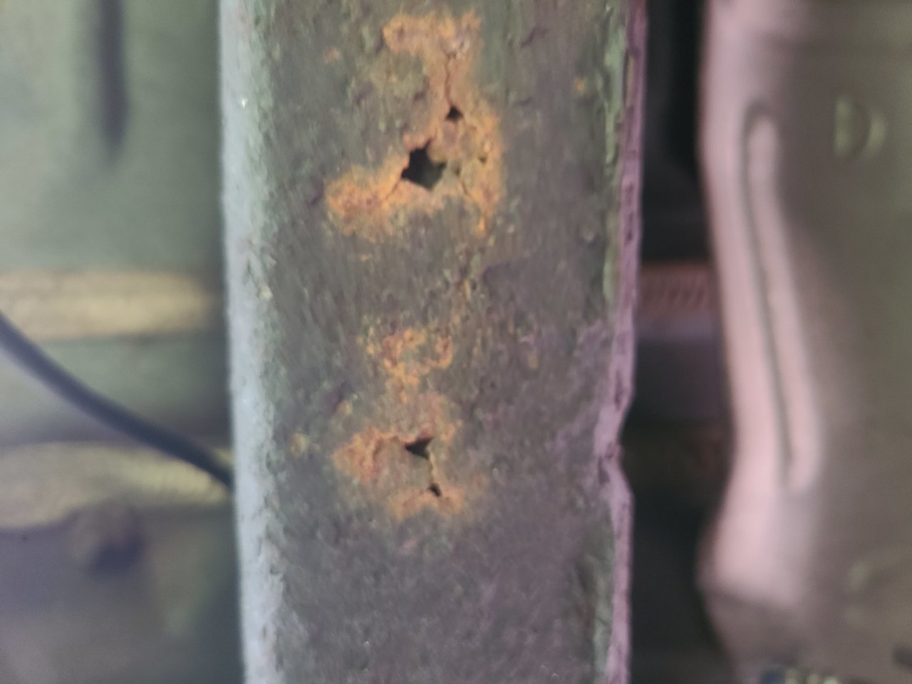

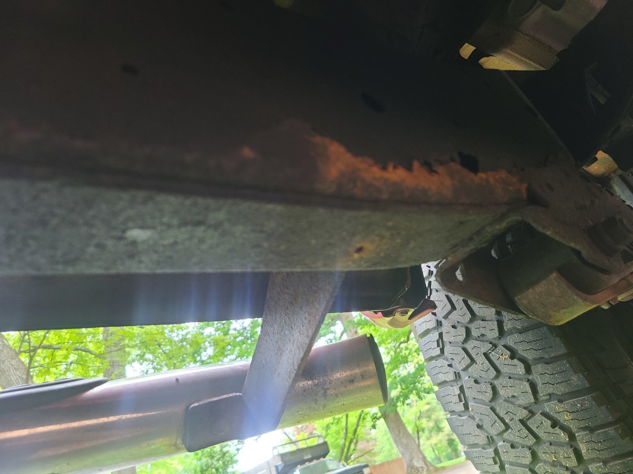

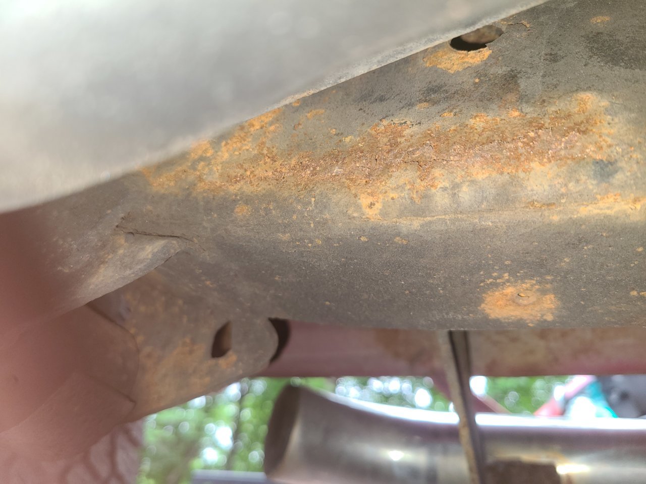

    I recently noticed my frame starting to go regardless of prevention measures so I bought a brand new frame from toyota late March of this year and was wondering if to just do the swap now or wait until the current frame gets worst. Below are the pictures of the current frame and the new frame. I think there were 2 left when I got mine. Thanks in advance

    Wait until there is no choice: i.e.: until it suffers the disastrous "broken-back" failure, fails inspection or "you just know it's time". While you're waiting, inspect everything and start picking up and stashing the parts that will have to be replaced because they won't willingly come off the old frame without destroying them.
    My son's 2005 Access-Cab underwent frame replacement a few years back at only 145,000 miles. No exaggeration: Almost everything attached to the frame was replaced: front end components except the springs, brake and fuel lines and related brackets, shocks, all the mounts for everything: body/cab, engine, transmission. It was amazing.

    I drove them way worse than that although, I didn’t know it.
    Showed no signs of a problem.
    I’d say you’ve got a couple years before I would worry about it.
    Even at the point yours is it can be fixed.
