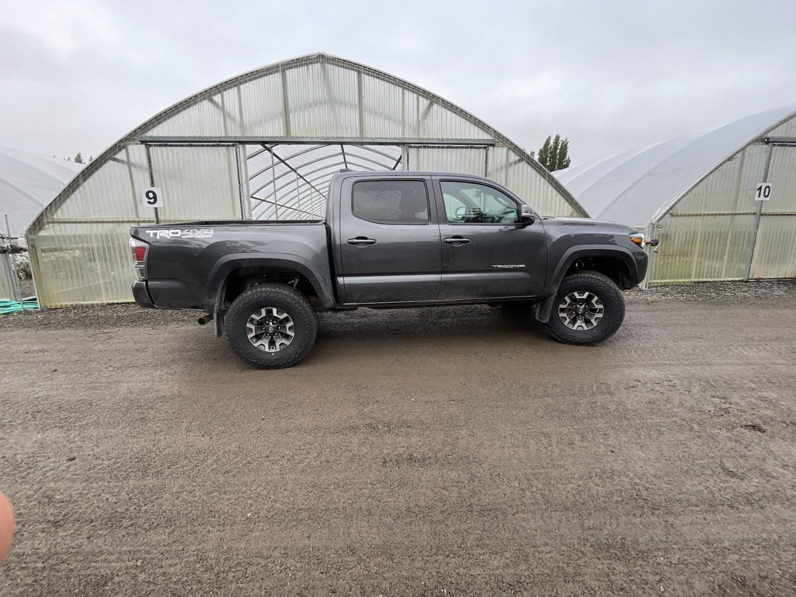

    I'm currently on a 3.5" lift with 285/75/r16 tires, with a body mount chop and I'm thinking of changing my wheels, how much negative offset can I get without rubbing on fender/wheel well and without sacrificing offroad capabilities?ADCreHdY-PkVKxg-P--VGw7Q5cVlL3zhYK0o02fx_0c2c23e5bce8fb59bd6961f8a7fd47b6bfde173b.jpg ADCreHftAunI1htPowsmjxgktf5EYR-HraU4aH3R_4d410f763bf3792af4856afa789facbf2cec5445.jpg

    Might be able to get away with a 16x8 -25 offset wheel. Others will probably chime in. I know when I was on 285/75r16 I ran -12 offset with no issues.

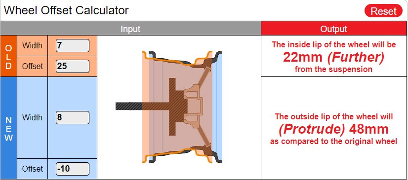

    @brickedforchess65 you will find that -10 and 0 offset wheels are readily available in many designs such as Black Rhino, Fuel, and Method. Here is a LINK to our website to give you some inspiration.

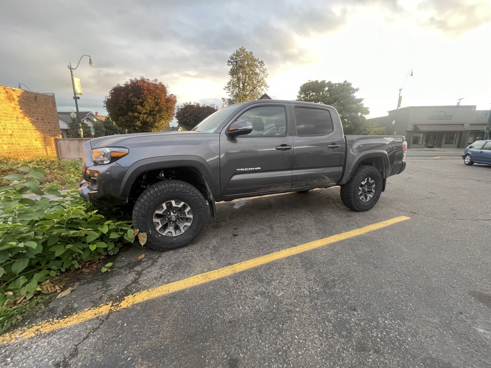

    I’m running -10 with a bmc. I don’t rub often. I didn’t want to go too much of a negative off set cause I wanted my tires to tuck into the fenders and not rip my fender flares off with such a high negative off set. ( peep that rear tuck!)
