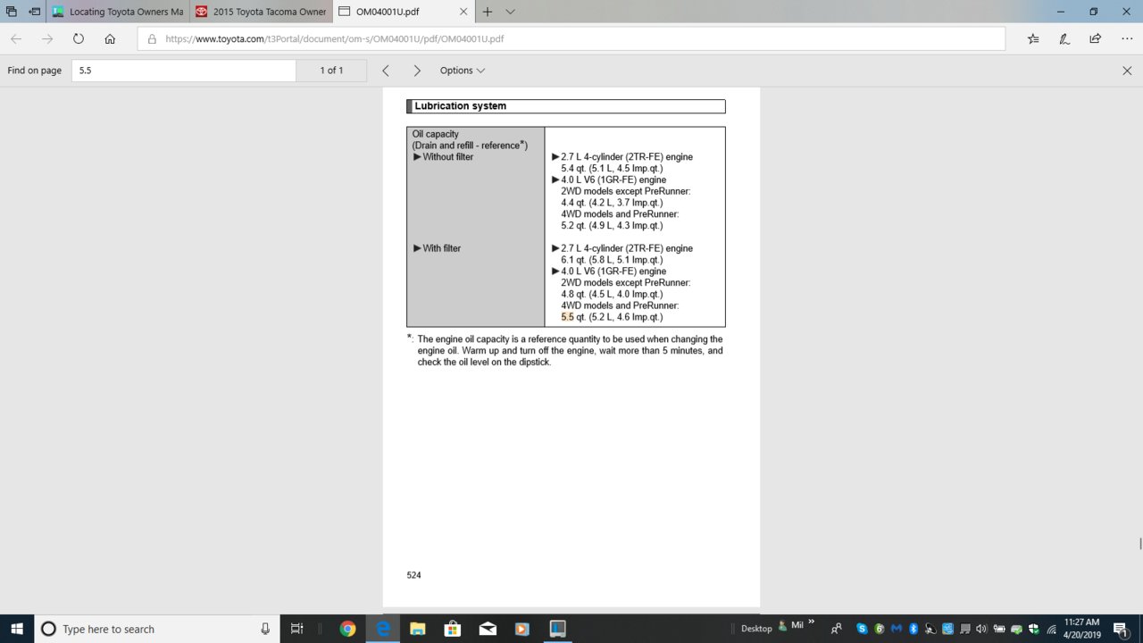

    I'm more inclined to follow the advise of the mfg. than make up my own rules. I suppose there can be exceptions, but oil qty. is not one of them.
    There are some 2WD models that call for 4.8 qts. That may be why some see the oil at the full mark using 5.0 qts.
    Mine is right at the full mark with 5.5 qts. - PreRunner. If I used 5.0 qts., I would not be at the full mark.
