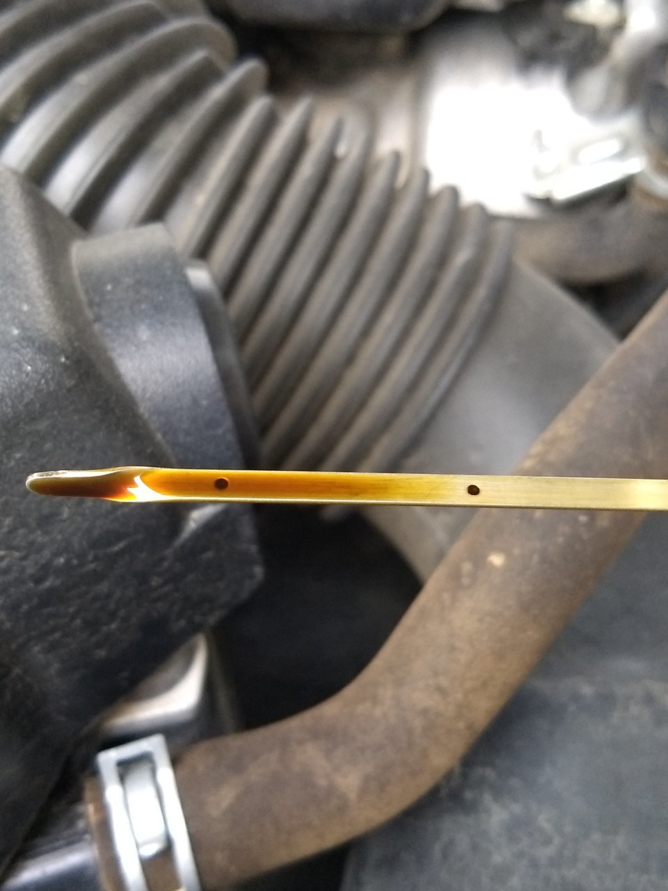

    OEM filters for my 4.0L, always just used a 5qt jug, sits just below the full mark, never an issue.
    Also protip on reading oil level. Warm motor, park it, pop the hood, pull the dipstick out, let the truck sit for 15 min or so, then take a reading, also scuffing up the end of the dipstick helps.

    If I change oil using 5qt. and an OEM filter, then check it the next morning (after all oil has drained down) my '06 1GRFE will be EXACTYLY on the full mark. Manual says do not overfill for a reason. :thumbsup:
