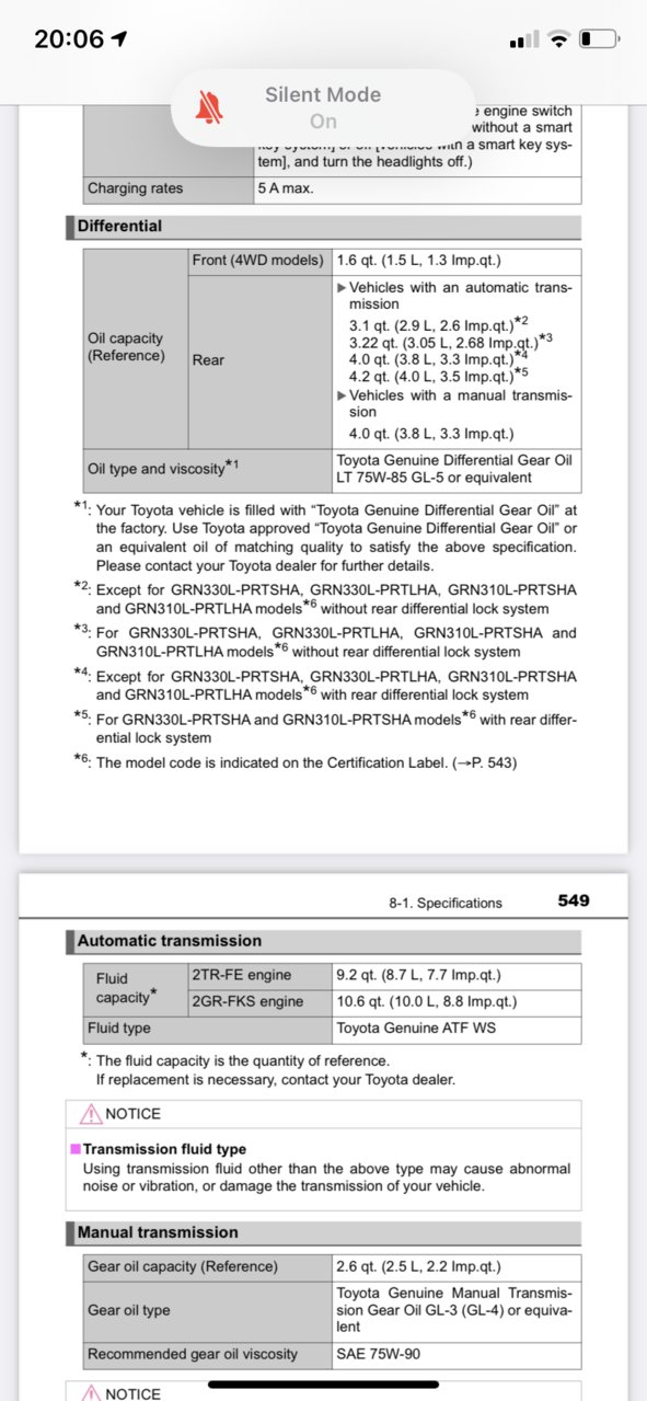

    Everyone been searching through some posts and trying to figure out how much oil I need for both the front and rear diffs.
    Trying not to over order since that amsoil is expensive!
    Thanks in advance

    It’s in your owners manual.

    Like the others said before me, check the owners manual, you’ll have to look at your door jam as well for your engine type (something like GRN-etc). That info will also be in the manual. Once you have that you’ll have the exact amounts you’ll need.
    EDIT: just saw you don’t have it. do you have the manual on your phone via the Toyota app?
    EDIT 2: here’s a screenshot I grabbed for you off my phone

    You all are fantastic!
    Now i can order it so it'll be there when I get back

    You can get a pdf of the manual from the Toyota website
