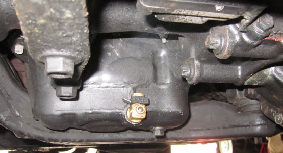

    I was tired of having a 1/2 quart leftover so I went this route. I did some estimated calculations, then added 1.25" to the bottom of my oil pan, added a fitting for a fumoto, and it now holds 6 quarts even with a filter change.
    In hind-sight, the next time I'll use two oil pans, add half a quart of liquid to it, mark it, add about an inch, cut it, then slide it over the other oil pan with the drain plug removed until liquid comes through the drain plug, and weld it. That way you only have one weld to make around the oil pan.

    LOL, that is a lot of work over a half quart of oil. It does look like it turned out well for you. Good job.

    It wasn't too much work. I think if I ever do it again I'd use either a Tig Welder or braze it. With a wire feed welder, you expose yourself to a greater chance of leaking around the weld.
