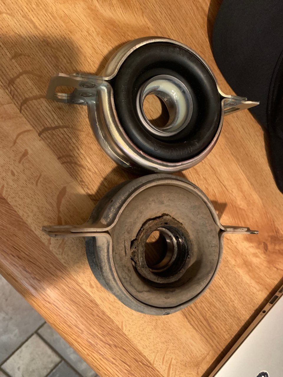

    I think maybe I might be up for an award for the most messed up center bearing. Adding lots of pics and details to my build thread but here is a preview of hpw bad it was.

    OH NO YOU DIDNT please say it aint so.
