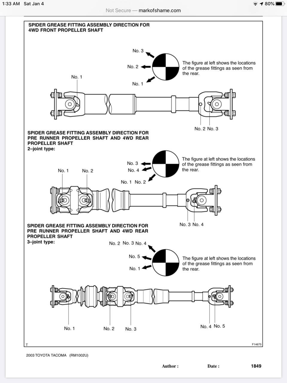

    I think all the grease fittings are supposed to pointing the same way from factory.

    I went by this and the match marks I had on the transmission and differential ends of the driveshaft. Could still be off by a couple of splines on the flange. 658EAB25-88BC-4C80-B4A5-C54E8637F4F1.jpg
