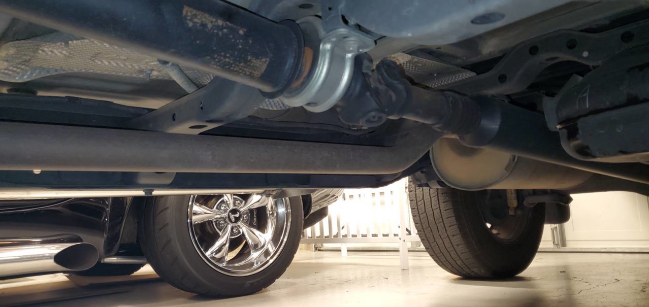

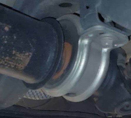

    Recently I've had a vibration in 2nd gear (only), and also a clicking sound when coming to a stop. I don't think the click is coming from brake pad knock-back.
    I finally crawled under the truck and the drive shaft easily moves up 1/4", although it's not THAT loose.
    The shaft does not seem to be 100% centered in the hole, but I'm not sure. It may be down a little bit.
    Videos on YouTube changing it out show TRASHED Drive Shaft Center Support Bearings so I'm not sure if mine is OK.
    I live in LaLa Land and after 200K the truck is in pretty much perfect condition, but I don't imagine environmental factors affect premature wear on this part.

    There should be a little play (it's flexible rubber) but that one does look a little saggy at least to me. If you can push it "up" more than 1/4 or 3/8" it's probably time to change it. Neither expensive nor difficult, and a good opportunity to grease your driveshaft splines while it's out.

    Typically it's the rubber. OEM is by far the best (unless you want to do an IEDLS Ranger bearing, not a drop in replacement). There are other options but general consensus is that the cost vs lifetime curve for OEM is superior.
