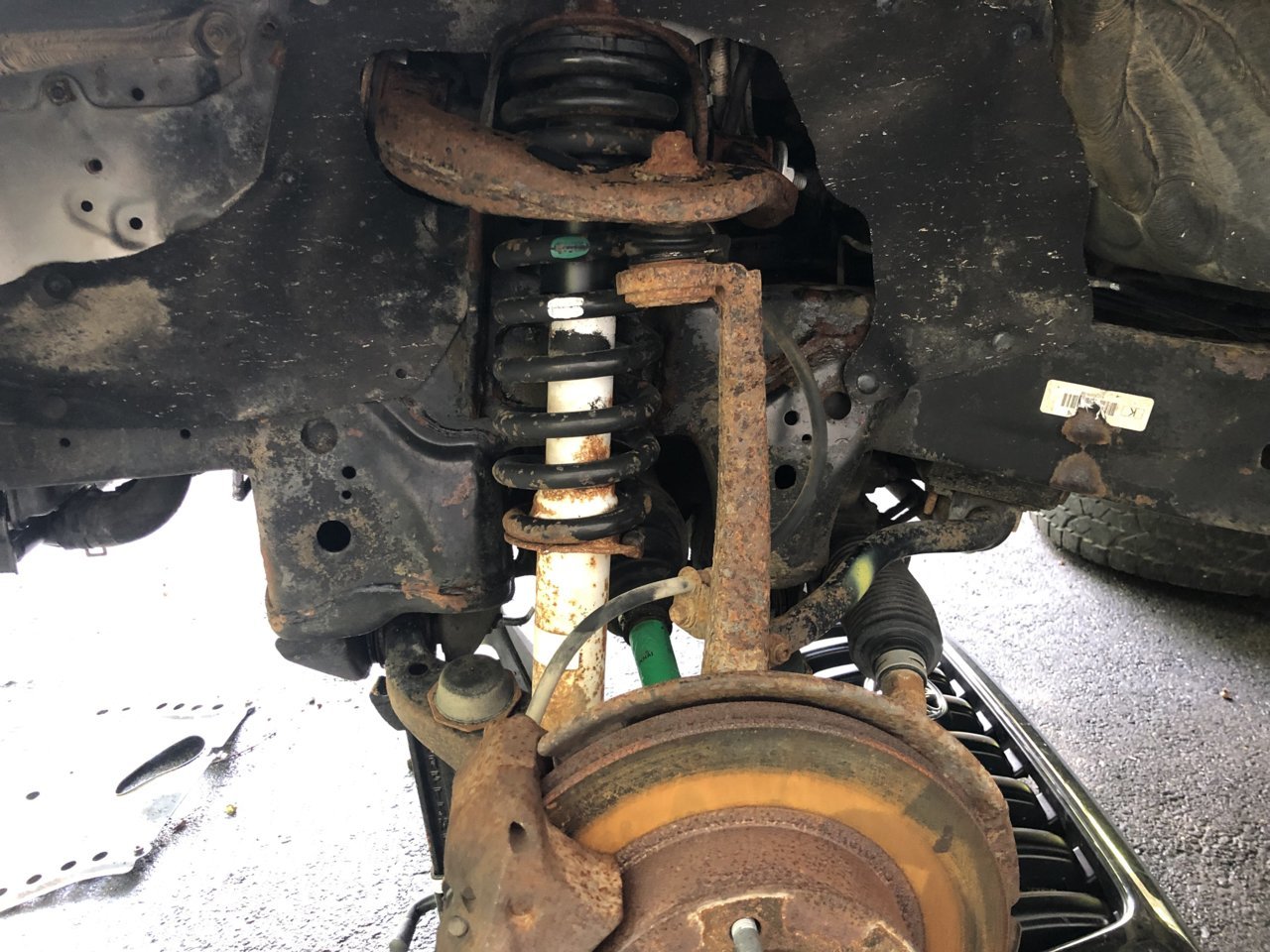

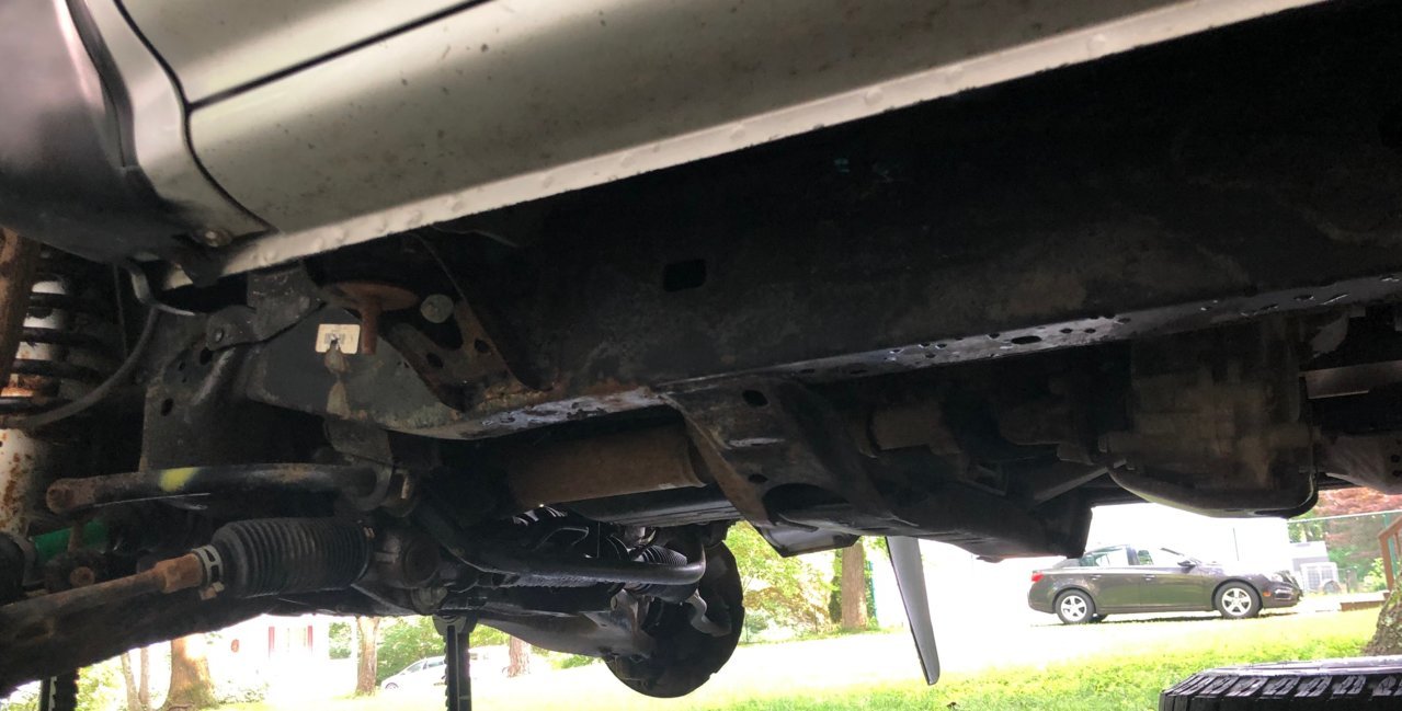

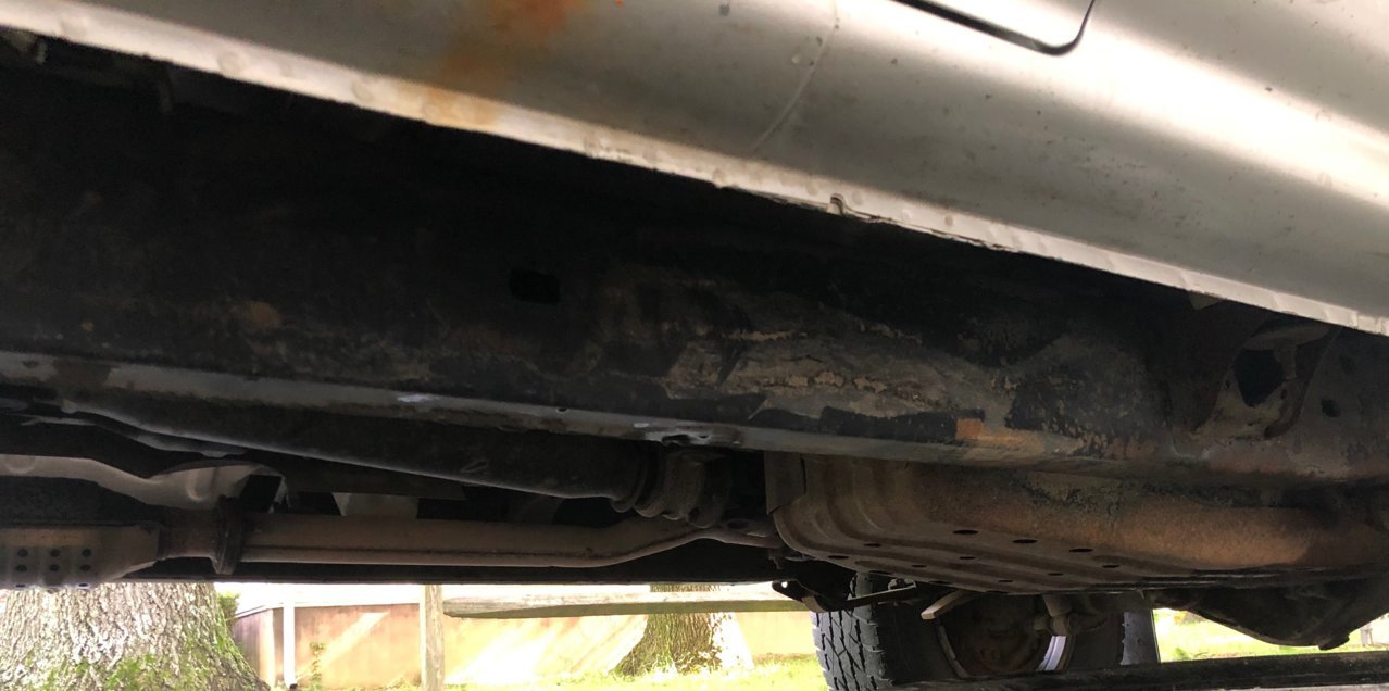

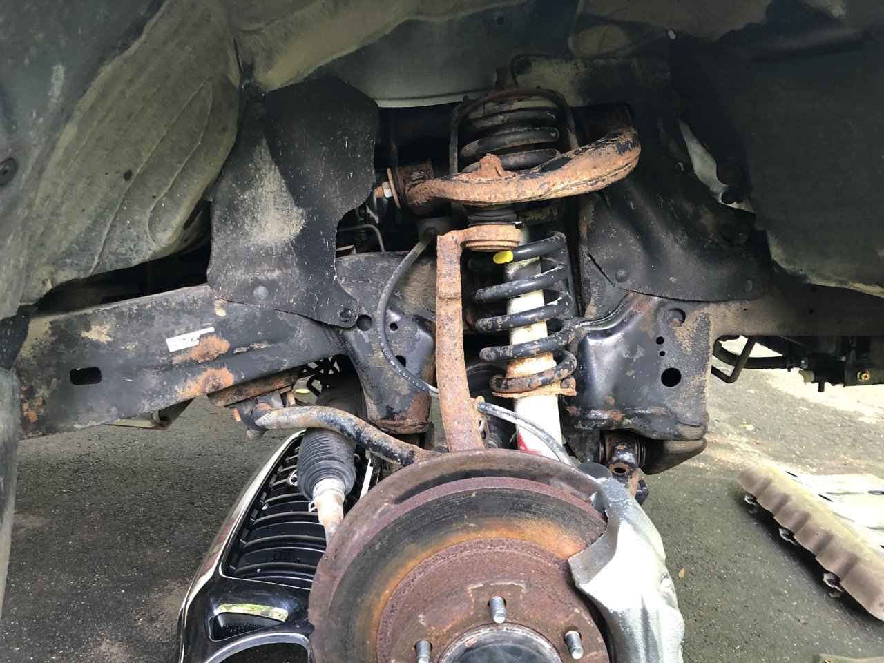

    Here are some pictures of the frame.

    it's a big project, but doable. Differing opinions here on the route to address.
    My opinion - scrape off all the loose stuff, wire brush all the rust, POR 15, Fluid film.
    POR 15 is not UV Stable, but POR 15 "top coat" is UV stable. FYI.
    How do you eat an elephant? One bite at a time. Set yourself little sections goals.
    And the beds come off really easily. My first gen it was 6 bolts & 2 wire plugs, & 4 screws at the filler neck.
    So much easier to address the frame w/o the bed in your way. 4 people can lift it off & place it out of the way.
  9. Jul 1, 2019 at 6:54 PM

  10. Jul 1, 2019 at 7:50 PM
    FLBAdrian
    FLBAdrian A Pretty Sizeable Onion

    That last picture don’t look to good

    It does look bad, but it's not. The black isn't a rust hole, its paint.
