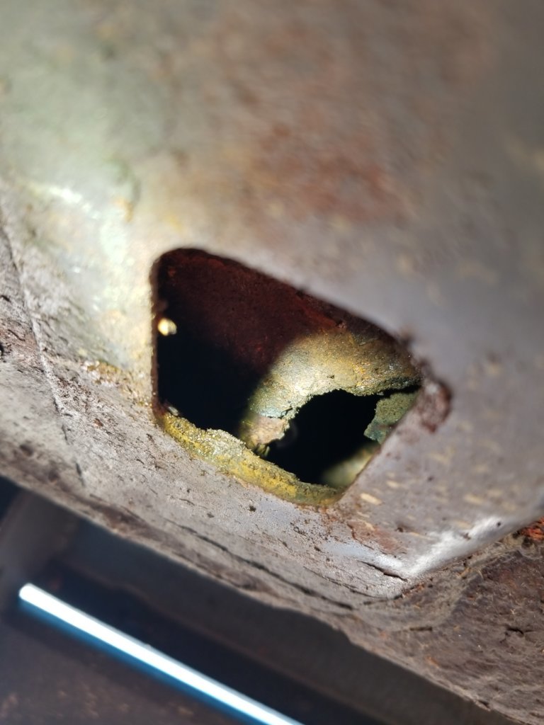

    My truck passed the inspection and just a few months later I had a huge hole form. Here's the chunk that came out...
