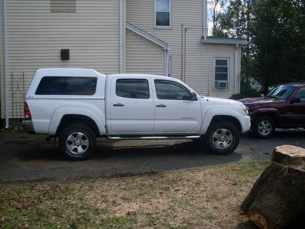

    I had a 2007 DCSB 4x4, 5100's up front with Eibach coils (Billies at 0) and I installed the Icon 3-leaf progressive AAL in the rear with a TSB leaf pack and I kept the overload leaf in place. It's a 1.5" AAL but is intended to be run without the overload leaf. Since I kept the overload, I ended up at 2" of lift for the rear and that gave me quite a bit of rake. If I had kicked the billies up to .85, I would have ended up with a very slight rake.
    Here's a good side shot of the setup. Keep in mind, I have an extra 200 lbs in the bed also aside from the shell weight.

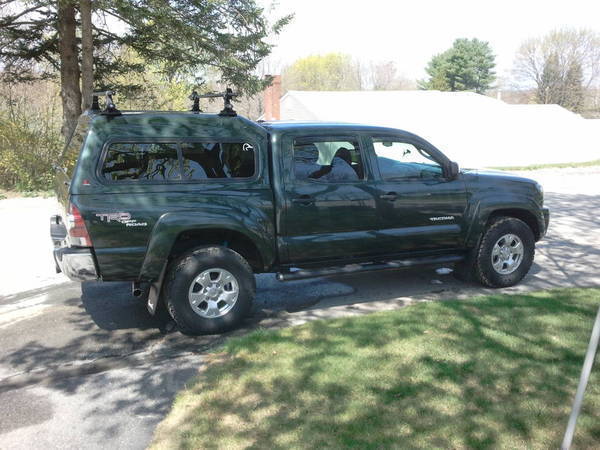

    No noticeable sag on mine....all stock shocks, but I did have the rear Leaf spring TSB done.

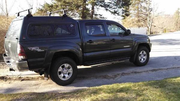

    I bought my truck new in May of 2011 and had the cap installed 3 weeks later. I had the TSB done in December of that year because suspension was bottoming out on the slightest of dips in the road with a light load. I've had it freighted numerous times since and don't even really notice much sag. I think the new leaf springs are holding up nicely as my rear is still sitting higher than the front.
    Here's a more recent picture too.
