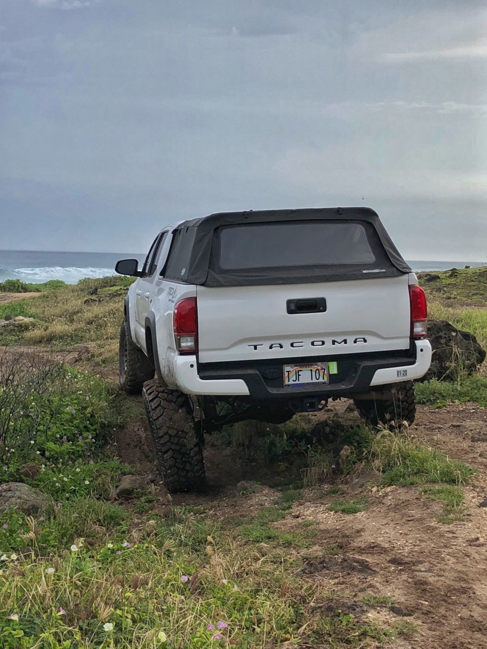

    Elias
    Oahu, Hawaii
    ‘17 6MT DCSB 4x4 Off Road Super White
    6” BDS coilovers w/ dsc Black Rhino Madness wheels 18x9 -12 Firestone Destination MT2 35x12.50 CMC Flowmaster 40 series muffler TRD Pro grille Softopper
    Garbage? lol, I have this on my truck with 35’s and they are awesome on and off-road. I have a bunch of friends with 3rd gens with 3” lifts and we all Offroad together. It really makes no difference. If anything I get more clearance to the front bumper, side body, and rear bumper, and about the same clearance to the front diff because of the diff drop. I’ve never had any issues off road.
    But I still needed to do CMC and trim some plastic for full compression while turning.
    Here’s a pic of some flexing my brother snapped of my truck while he was driving behind me.
