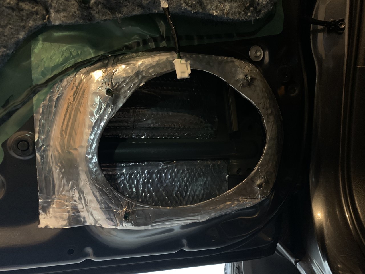

    18 sq feet do the doors inside and out, I dont have a number yet for the floor, but the back wall took 4 sheets or noico (each sheet is 2sq feet) for the wall up to the underseat storage bins

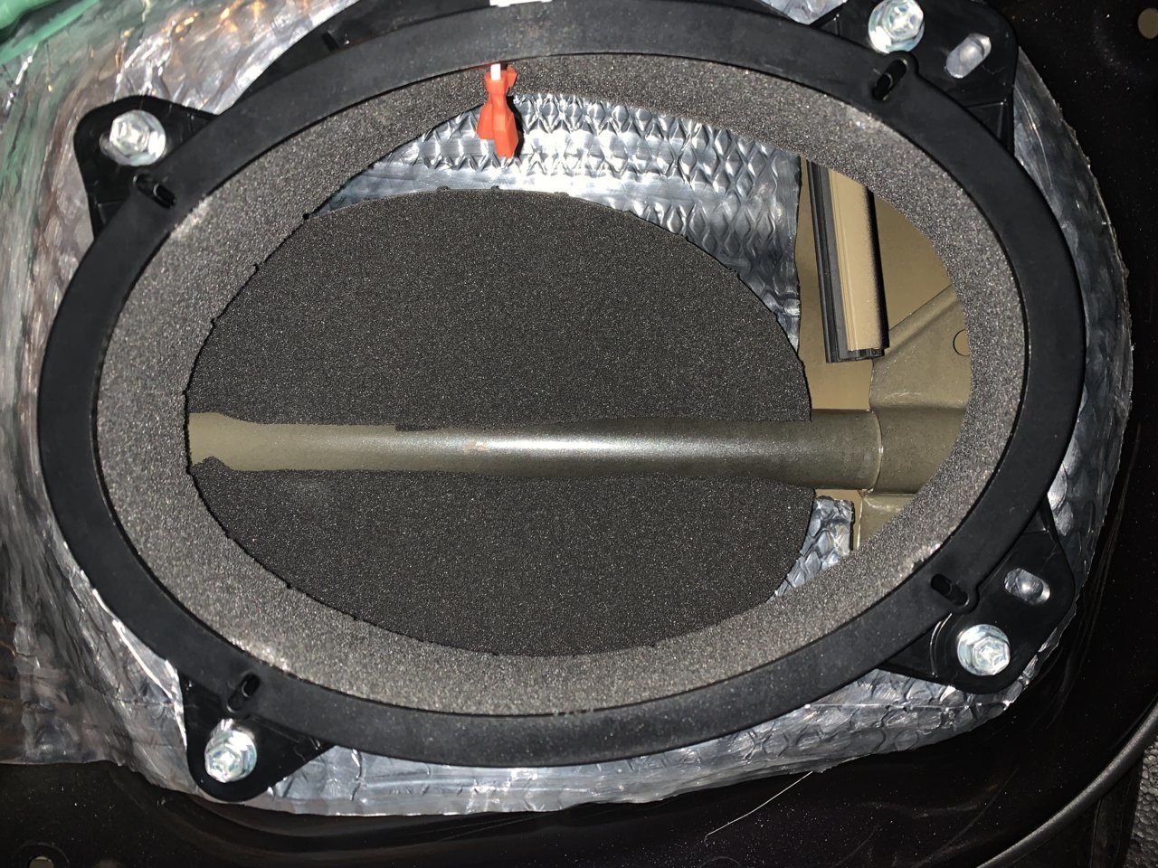

    I dont have any of the back wall, but this is what I have for when I did the doors. I didnt really get many pictures because its pretty boring.

    Around the speaker and behind. No pic but did the entire flat space inside the door about half way up both front and rear with one $35 box. That foam is Stinger Road Kill kit.

    I also did parts of the door panel itself, I put strips on any place there is a plastic weld, I also put some around the speaker area of the panel to prevent the panel from vibrating too much.

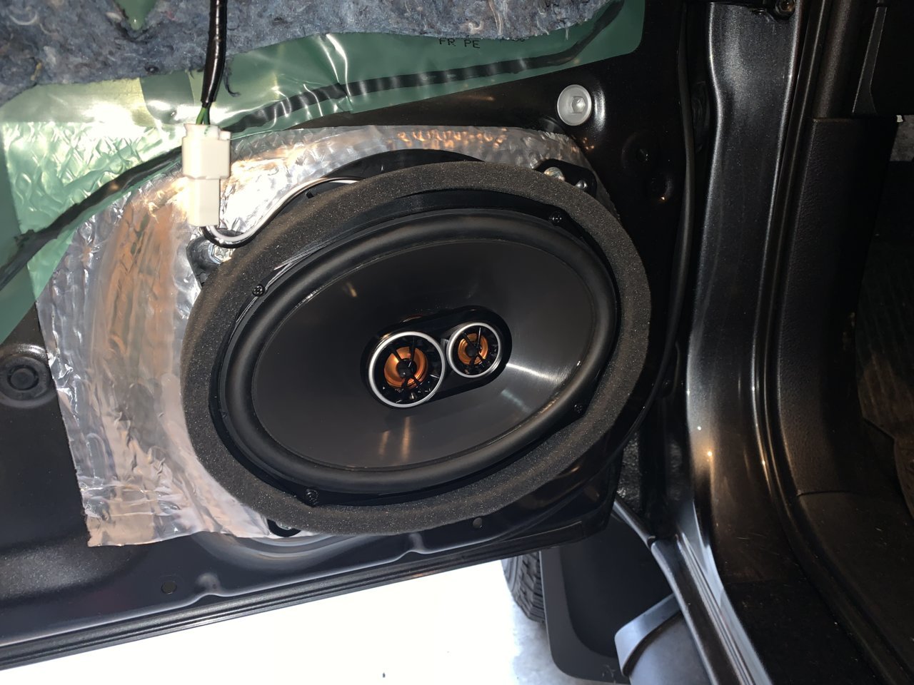

    Maybe this helps. It's info from second skin audio.
    The approximate sqft of your Tacoma is as follows:
    Floor 35-40 sqft
    Doors are a total of 24-28 sqft
    Back Wall 12-15 sqft
    Ceiling 25-30 sqft
    The advice I received was to also get some material on the crash bars inside the doors, as they resonate a lot. I've done my doors, and floor and back panel. Headliner is next.

    What does the foam do around the speaker?

    It will absorb some of that back wave and direct the bass forward. Helps the sound not disperse outward so much. Is anyone dying for not having it... no. Ever little bit helps IMO
