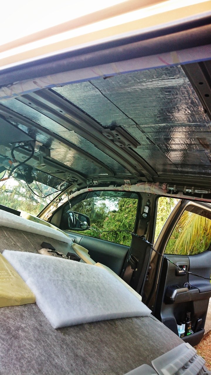

    Nov 8, 2019
    #310185
    425
    Shane
    Ohio
    2019 MGM TRD OR
    Yup been there too... the Tacoma is the silly putty of trucks IMO. You can do what ya want... just wish they would shave a little off MSRP for that :notsure:
    Travis17[QUOTED] likes this.

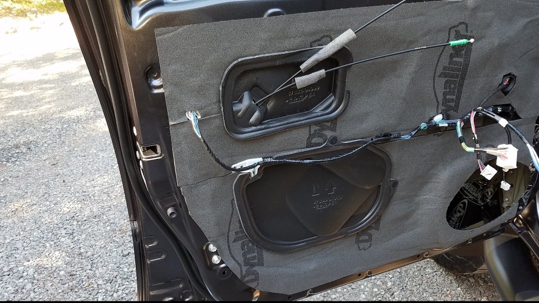

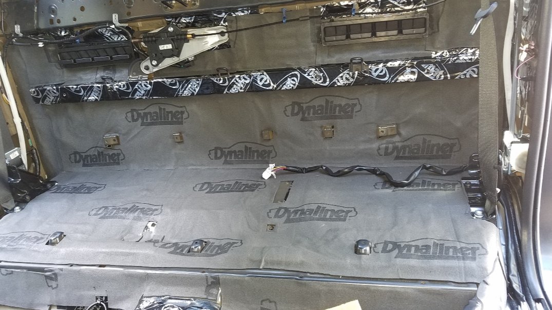

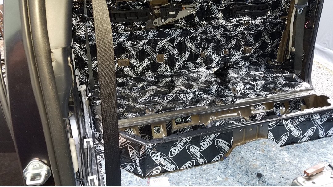

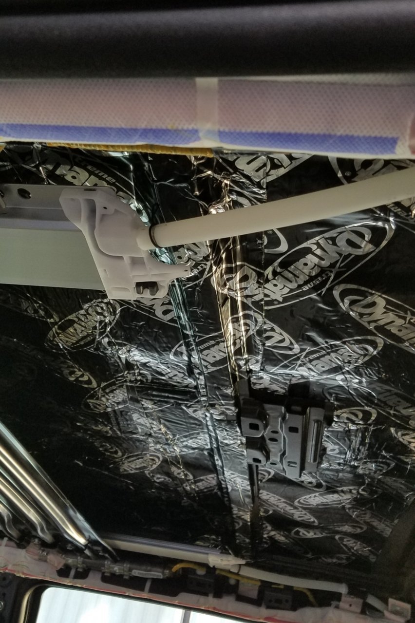

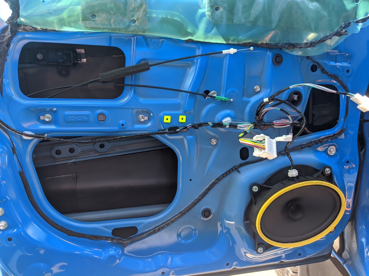

    I'm one who goes way overboard and did everything with dynamat extreme and dynaliner. Doors are both inner and outer skin.
    20200409_192631.jpg Screenshot_20200409-192132_Gallery.jpg 20200409_192940.jpg 20200409_192913.jpg 20200409_192853.jpg 20200409_192833.jpg 20200409_192730.jpg 20200409_192751.jpg 20200409_192711.jpg 20200409_192652.jpg

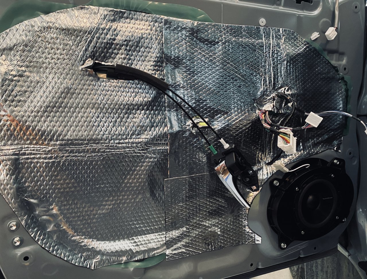

    Currently in the middle of doing mine, used noico sound deadening and thermal insulation. So far two doors down and haven't gone threw half the box off each. Doesn't really have a picture of the soundening as the foam goes over and haven't really taken any pictures of the process.IMG_20200408_141111.jpg

    Did my front doors a couple weeks ago. Will be doing the back doors and back wall next week when more dead we comes in. I used 18’ of Noico on the front doors doing the inner and outer skins. Two full sheets inside each door. Cut them into quarters and go over the bracing, over lapping the edges. Once you take the first door panel off, you will realize how easy it is. For the sail panel, remove the white clips from to door and put them back on the sail panel before reinstalling.

    I recently did the front and rear doors, the rear firewall, and the roof in Noico dynamat equivalent and Noico adhesive foam sheets. Massive improvement for nearly $0. Pretty shameful the car did not come this way from the factory.
    Headliner was a little finicky to drop, but not too hard. Frankly the hardest part(3/10) was feeding the sheets of Noico dynamat inside the door skin to adhere them to the outer layer of metal. Plus side is that the doors sound like they belong in a bank now.

    Here is a demo I did last year of a door with and without noico

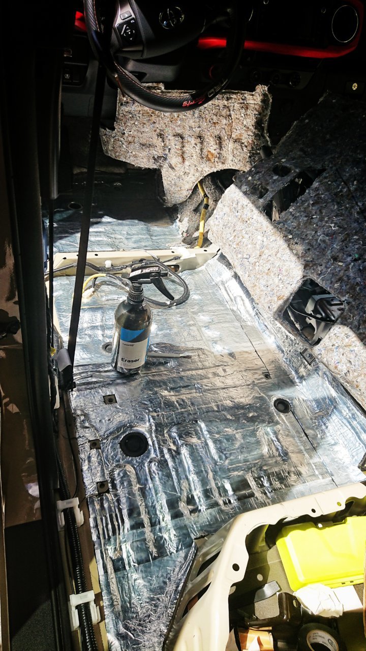

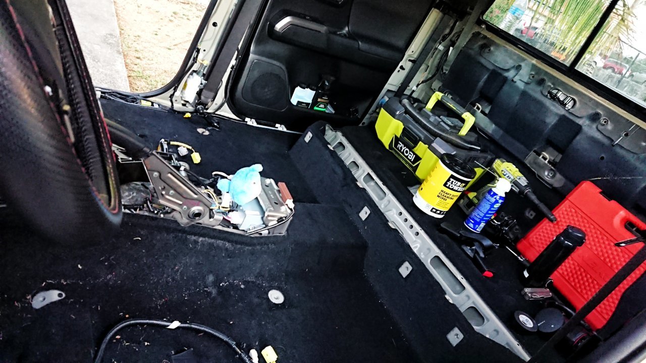

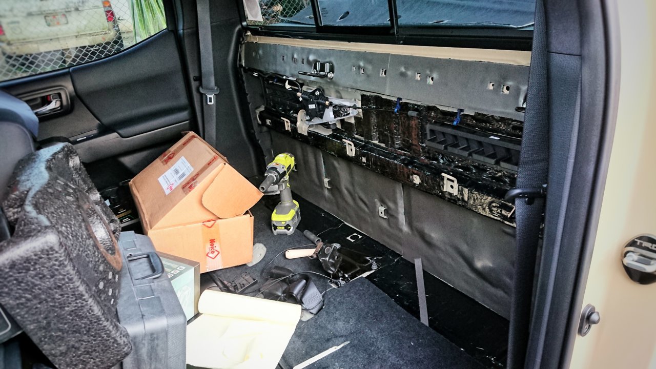

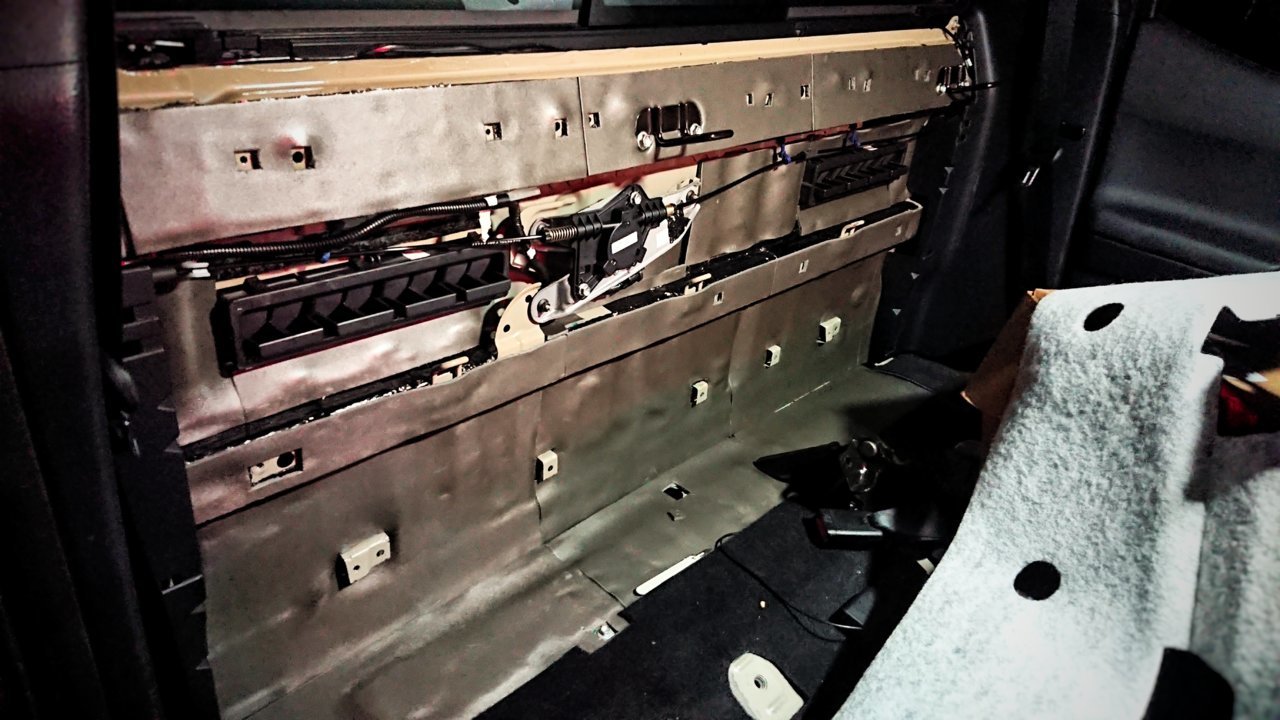

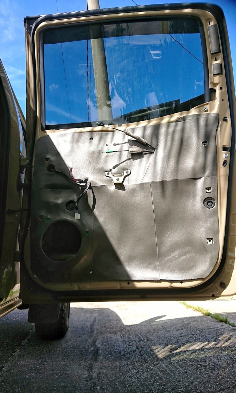

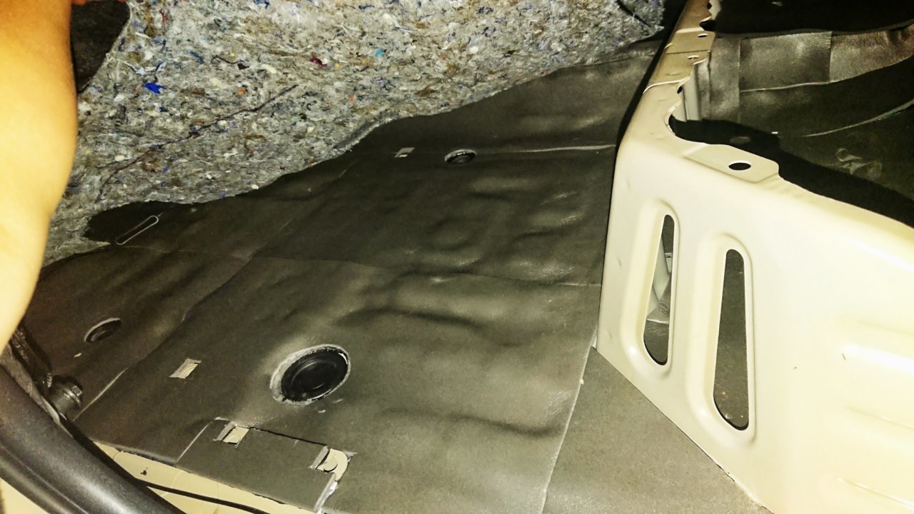

    Thanks to the lockdown, I had time to finish working on mine.
    80mil 36sqft Deadener for all 4 doors and the rear wall, and another 36sqft for the floor and headliner.
    170mil 36sqft CCF for doors and rear wall
    315mil 20sqft CCF for headliner and front flooring
    150mil 10sqft CCF for remainder of the floor.
    DSC_2169-01.jpg DSC_2170-01.jpg IMG_20191028_134922_749-01.jpg DSC_2891-01.jpg DSC_2892-01.jpg DSC_2903-01.jpg 1585814650140-01.jpg DSC_2911-01.jpg
    Started Sunday, finished yesterday.
    Couldn't figure out how to get the headliner out of the truck...
    If I had a helper, maybe it could have been done.
    Working around the headliner is tiresome and annoying.
    Planning on adding MLV to the rear floor and wall, and the doors.
    I think 40sqft should be enough.
