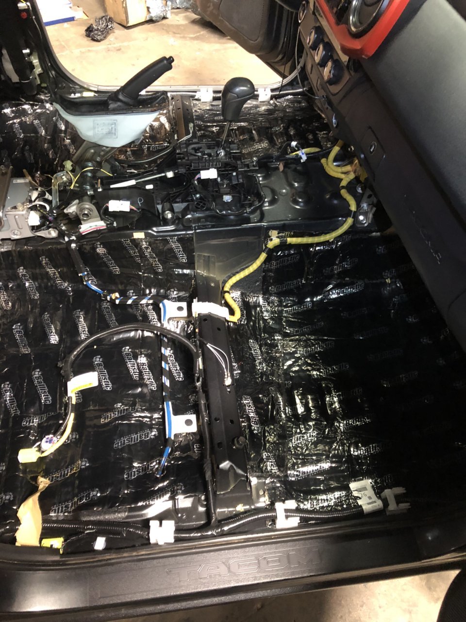

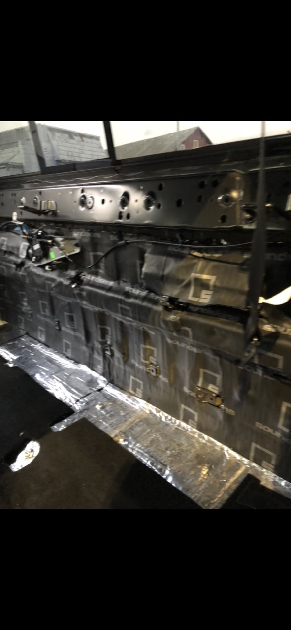

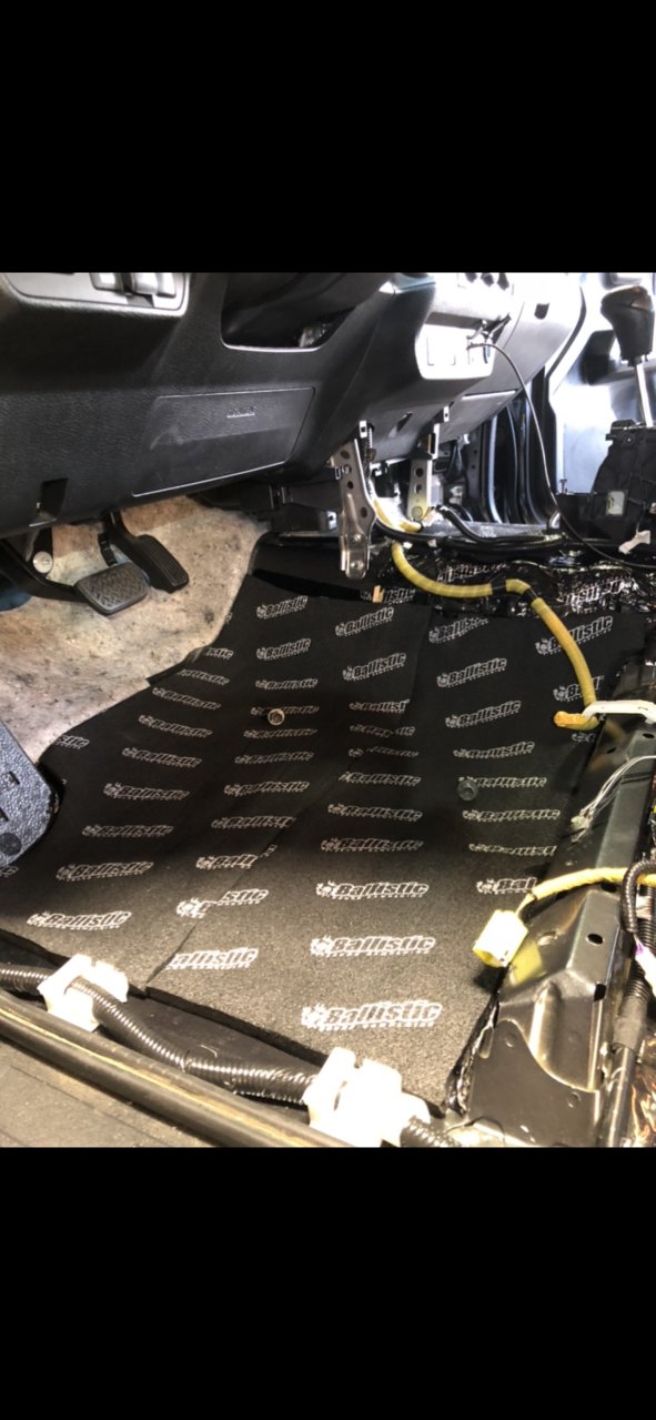

    I have put in Racesport gen3 leds I'm the process of doing a custom audio overhaul which will include Hybrid audio unity 6x9 mid bass, unity 3 inch mid driver in the dash and fiberglassing tweets in pilar soundeading all the doors, floors, and headliner and I will be using a helix processor to retain the factory radio and as far as subs I might make custom brackets to move rear seat foward a few inches to get a full size sub in there or I might just go with a pair of jl tw5 or tw3 and it will all be powered by jl audio HD amps or I might try out the new hybrid amps
    I used 5 bulk kits 36sqft per pack I used 3 kits of ballistic competition grade! Then two bulk packs of sounds skin pro(butyl,foam,and aluminum) and two rolls of 3/4 inch of ballistic sound dampening foam on headliner/floor I went extremely overboard!
