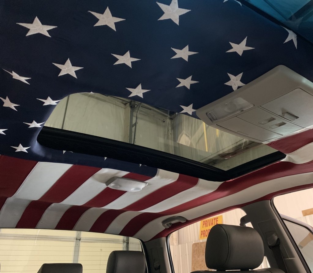

  15. May 5, 2020 at 8:33 AM
    #135
    TacoWdrd
    TacoWdrd Well-Known Member
    Nov 8, 2019
    #310185
    425
    Shane
    Ohio
    2019 MGM TRD OR
    We are talking head liners and I was just searching around... I'm driving this truck until it burns to the ground so if I go to the trouble to drop my head liner I am seriously considering this :thumbsup:

  16. May 5, 2020 at 9:06 AM
    #136
    shane100700
    shane100700 Bed, Bath & Beyond Crawler
    Jun 1, 2011
    #57578
    7,012
    Montana
    2019 DCSB, OR
    Rocket Boosters
    We can argue that the flag (he’s using and cut an actual flag here) being used that way is disrespectful. Beyond that though, it looks horrible, not to mention the stars are on the wrong side. So failures all around on that persons vehicle.
